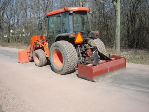

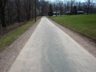

Just completed shoulder on 800' ID3 asphalt driveway. Ordered 66 tons modified...used about 50 tons. Used loader to spread, box blade to level. Drive is 10' wide. shoulder about 30 - 36" wide, 4" - 12" deep. Now a little clean up and a sealcoat job.

My orange helper.

starting construction on a 1500' driveway this weekend. interested in how you had the box blade adjusted. any insight welcome!

pseudofarmer, I adjusted the box blade slightly "tail down" and set the "teeth" all the way up....used 3 pt to hold blade 1"above blacktop...."rolled" modified with turf tires and loaded bucket and weight box...trimmed edges with bucket flat...blew off asphalt with leaf blower. See my post under original for pic of box blade.

Vince, That is one fine looking driveway! I love driveways....there's just something great about a well manicured and cared for drive....and that's one of them. Excellent work.
