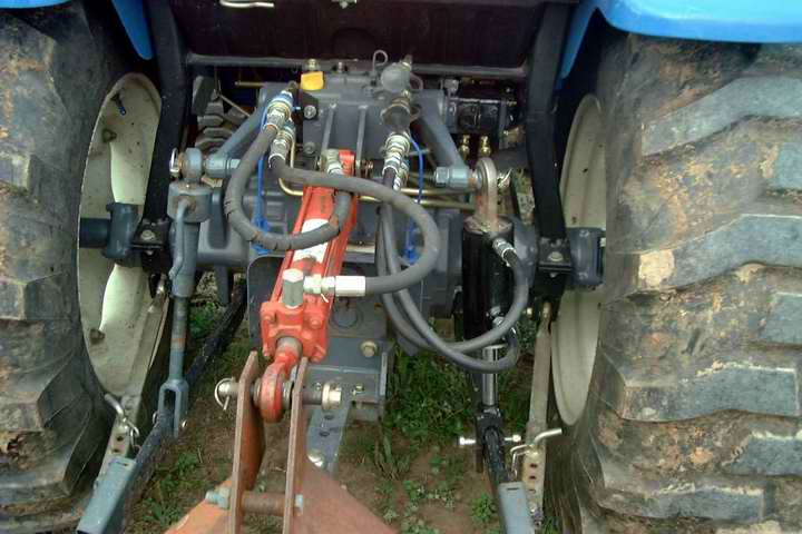

I keep hearing that there are dealers giving people blank looks when they ask about top-n-tilt cylinders. I think we should post photos so when someone wants to get TnT for their tractor, they can just print out the photo of the setup on a tractor similar to theirs and take it to their dealer.
What do you think? Can we get a bunch of photos here? If you only have just a toplink cylinder or sidelink cylinder, post that too. This is such a great addition to my tractor, I wish it were a factory option. /forums/images/graemlins/cool.gif
Okay, I'll start with my setup on my TC45D (see attachment). The bolt holding my sidelink to the liftarm was a temporary fix until I got the hole drilled bigger (I had to buy a bit.).

</font><font color="blue" class="small">( That toplink hose looks very cracked? Or is it the photo or moisture or sumpin?
)</font>
We all wrinkle and crack a little with age... /forums/images/graemlins/crazy.gif
/forums/images/graemlins/laugh.gif
In the case of two-wire hydraulic hoses, the outside covering is purely cosmetic and has little or no value. Mine has seen over two years of Texas sun with SPF-0 sunblocker applied. /forums/images/graemlins/blush.gif
If the hose ever leaks or the wire becomes frayed, I'll get new hoses. They're too darn big for the toplink cylinder anyhow. You only need a tiny flow. I actually think that big hoses "balloon up" and allow the cylinder to move as much as 1/2 in. in and out. One of these days I'll buy a piloted checkvalve type cylinder and new hoses. ...maybe when I quit being "Mr. Cheap." /forums/images/graemlins/grin.gif

</font><font color="blue" class="small">( Also, do you ever experience the tilt cylinder not holding a 3pt load on that right arm? )</font>
If you mean bleed-down, I have noticed a lot less on my tilt cylinder than on my toplink. I've seen none. I use my rotary cutter and don't have to readjust at all to keep it level.
If you mean weight load, that's not a problem either. The total weight felt on that lift arm, even with a load of over a ton on the 3PH, would be only half of the total weight. With 2,500 psi of hydraulic pressure and the size of that cylinder, there's nothing I'd want to lift with my tractor that the tilt cylinder won't hold.
