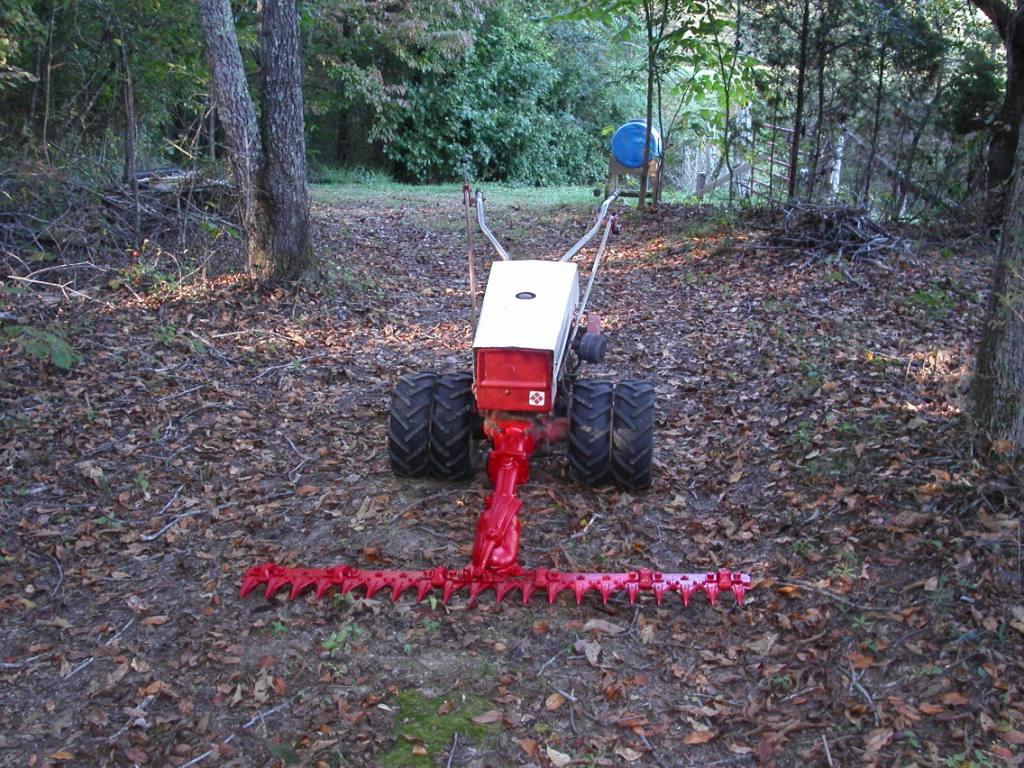

Here's what the BIG Gravely sickle is like. This is the 60" model. They also made a smaller one, 48" I think.
24", 30" 36", 42", 48", and 60" models were made. The 24" one isn't really practical for an L or later and should only be run on a D. 30" and up is fine on an L or later models and matches the 30" rotary. With duals you are better off with the 42" or bigger as you won't be running over what you need to cut on the next pass.
