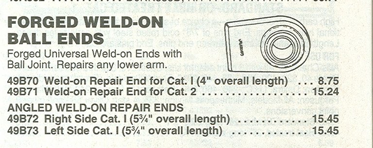

In addition to the information supplied by soundguy you can pick up these weld on ends at places like Tractor Supply. You simply cut your old ones off and weld these in place, walla new ends. /forums/images/graemlins/grin.gif
They also carry them for the side links and lower lift arms.

Good point!

I don't think that it would be a practicle repair to weld a new end on the side link on our Yanmar. So I'll just buy a repalcement.
cvt
/ Side Link Repair #6
Why not?? That's what they make them for.. way cheape rthan a new set of arms.
Soundguy
/ Side Link Repair #7
Welcome to TBN CVTintera !
I have to agree with soundguy. Even if you dont weld you could take both arms to a muffler shop and most likely for a 12 pack you could get it welded. The reason I say take both so the length can be matched.
