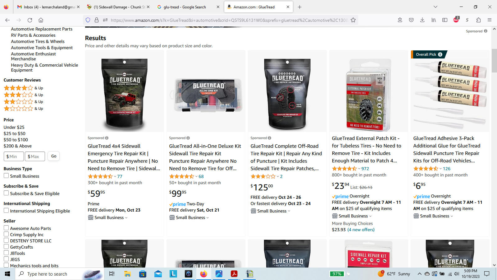

Prior to joining and posting, I did a bunch of searches on what my question is regarding, but I couldn't find any that seemed to match sufficiently, so I apologize up front if there are glaringly obvious posts that I missed! I live in a pretty rocky area and after clearing an area for planting, I noticed that I had some damage to one of my front tires as can be seen in the following:
I have not noticed any leaks whatsoever over the past few weeks, and was wondering if I should simply just try to apply some sort of adhesive and push that piece back in so it's flush. If so, is there a recommended adhesive? The tire is a Galaxy Agri Trac II "r-1" a6 9.5-24. I did come across threads that recommended various vulcanizing agents, but I couldn't find information as to whether these work with all tires or only certain types. I also came across GlueTread, but I don't know if I can just use their adhesive without the patch. I was hoping to avoid the patch because in my mind the patch will just be sticking out enough to make it so that it'll more likely be caught and/or pulled off as opposed to just getting that piece sealed and flush again.

My preference would be to glue the piece back in and then place small boot patch over the outside.
Or go with the gluetread I have been looking at some of there kits and considering getting one to have on hand.
Either way will help to protect the gouged area and keep dirt and debri from getting into it and causing more damage.

Thank you everyone for your very helpful and informative replies. I think what I'm going to try first is simply using an adhesive to bond the piece back into place and then watch to see what it does. If it comes off for any reason, I'll patch it using GlueTread.
