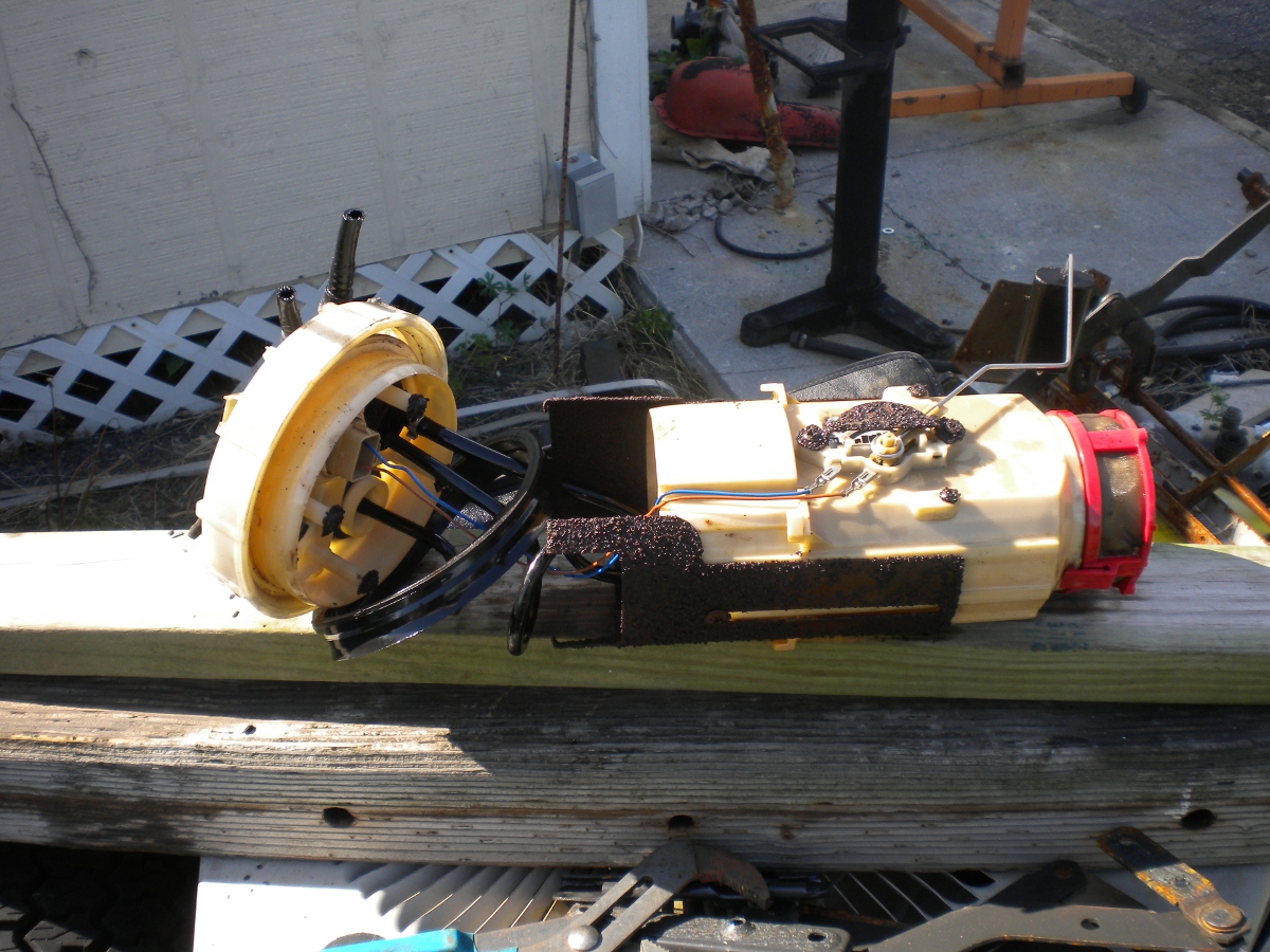

I have a LOT of experience with diesel engines, a lot of them in generators where I hold a bunch of certs.
I have always been a bit leery of additives. Diesel is a lubricant. We used to start engines that hadn't been run in years. They would smoke a bit at startup but would run just fine and I knew they had no additives.
I bought a 97 Dodge Cummins from my brother that he had bought new. He was an additive guy and used them from day one. The fuel gauge quit working. That did not bother me but I decided to fix it in 2012 because I had the time. Expected to see the float maybe bad, NOPE! The entire apparatus had rotted in half inside the tank! While I did not send anything off for testing, I can think of nothing that would have done that to a piece of equipment immersed in diesel fuel other than the influence of the additives. I have never seen diesel fuel rot anything, it generally protects things.
That said, my BX-25 can be a huge bear when it gets really cold, to the point where several times after a big snow storm I have found myself laying under it trying to change the little tiny fuel filters, so I do use the white, and occasionally the Diesel 911 in the winter time. No troubles after that, but I never use it during summer months.
So, in my humble opinion, you use additives when you have a known problem. We did use antifungicide in our large generator tanks, and only because we had a reason.
Just my .02.
