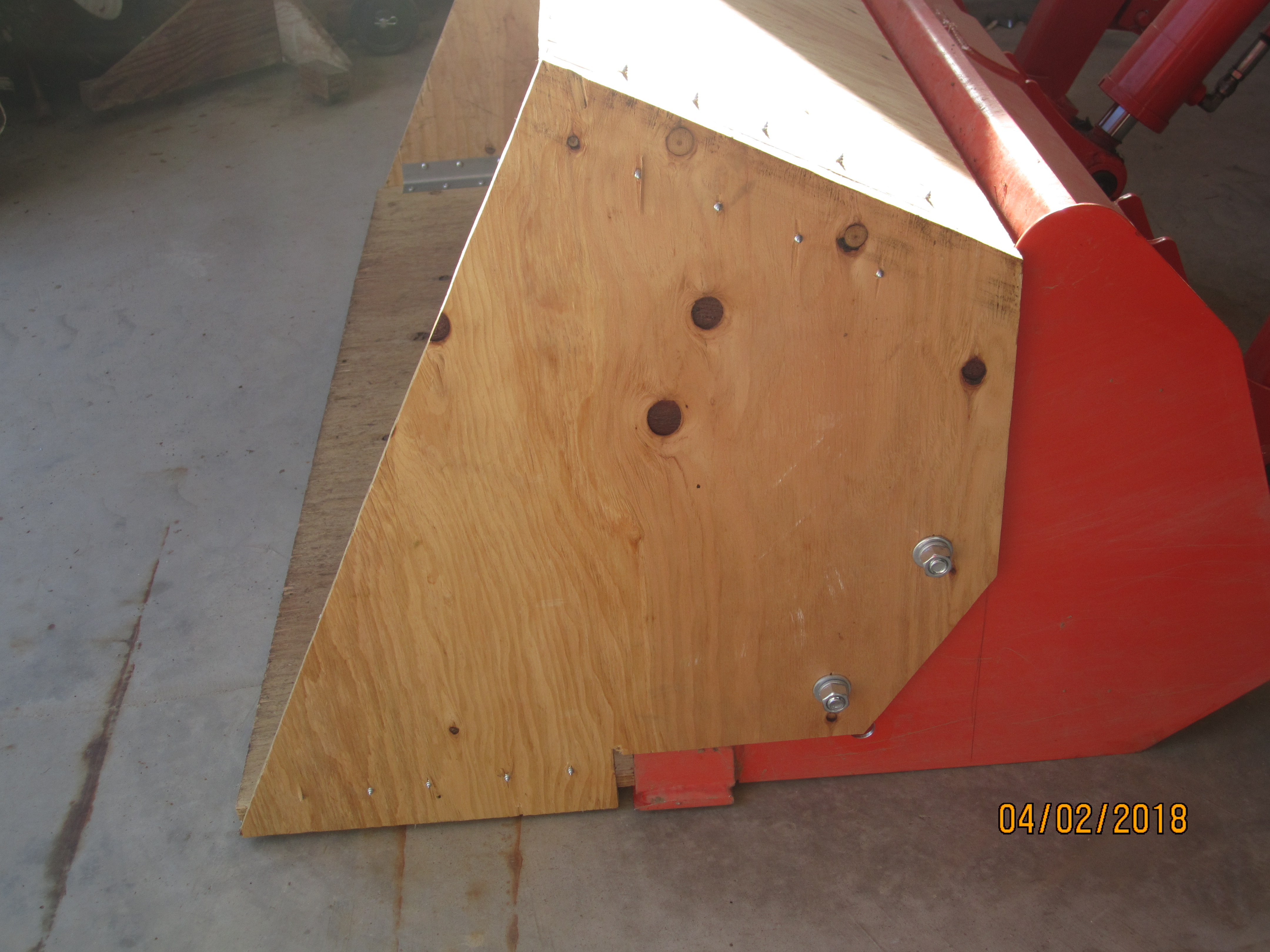

Its a axiom of tractor ownership that whatever you think is big enough is too small. The BX bucket is like this - its only 3-4 wheelbarrows. Moving something light like leaves one bucket at a time is just not tolerable if you have many leaves. So I made this very simple plywood bucket extension. Has lasted several years now and done the trick. Not for moving dirt of course. The hardest part was getting the pattern right for the sides (trail and error with clamps and cardboard etc). Not up to some of the fancy projects on the forum but it works.

Nice. My suggestion would be to hit the ends of those screws with the ol' angle grinder before someone ruins their pants (or need stitches).
   / Simple BX Bucket Extension for Light Material
Photos are from right after this was built. I'v been using this for a couple of years now. those screws tips are long gone. but thanks for the comment.

I like it lots. If I was you though, I'd replace the wood screws holding the corners together with screws/washers/nuts.
