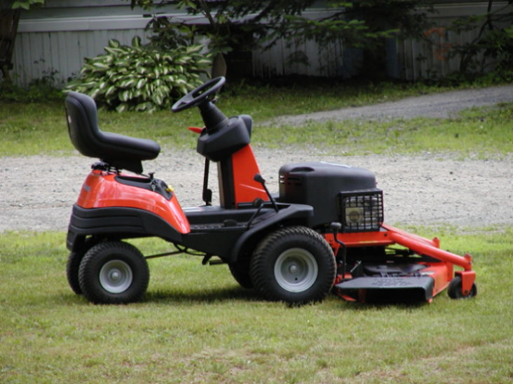

Update !!
My first impression of the Simplicity "Lancer" was. What The He11 Have I Done !!!
But !!!! The more I play with it and feel it it out, the more I like it.
</font><font color="blue" class="small">( but it does come with quirks that took a little getting used to.)</font>
Bob;
Your not kidding !!!!!!!!
I have never driven a forklift or any other rear steering machine. Quite an experience in a small lawn mower. I am so used to my walk behind and my lawns that while mowing today, I copied similar paths and movements. While trimming the outer edges closely, I would steer around a rock, only to stuff my my tail end into the tree branches. Oops! Tail Swing !
Branches that I am used to and able to duck under, while walking behind the walk behind mower, I can't seem to duck low enough with the rider. I suspect some limb trimming is in order !!!
With my walk behind I can lock one brake and pretty much make a zero turn, can't do that with the Lancer. I will just need to alter my method of attack. More learning curve !
I believe and feel that with a little time to overcome the learning curve's, I am going to like this mower very much.
Attached and following a several pictures of the lancer.

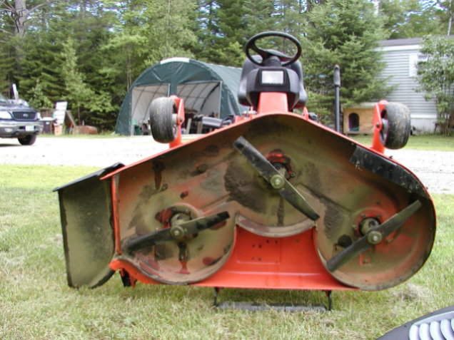

Knowing that the mower deck rotates up for servicing, I wnted to know. How to accomplish this. I eventually discovered that if you need to remove a pin on either side of the mower frame.
Once these 2 pins are removed, you can lift on the front of the mower deck and rotate it upwards. But First , please do as I say and Not as I did and read the Warning label that clearly states to "Remove the Drive belt Before Servicing"
I did not read or even see this label and without a manual to assist me. I of course lifted the deck, "once learning how", without removing the belt. I looked it all over, washd it down with the hose and lowered the deck and replaced the pins.
Within my first 4 feet of mowing today I thru the decks drive belt. I now know why. When I lifted the deck without removing the belt, I upset the alighnment of the belt on the pully's. It took sleeping on the matter for me to figure out how the belt went back on properly. Whould have been alot easier with a manual. /forums/images/graemlins/confused.gif
picture of mower deck rotated up into the service position

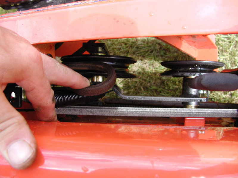

Now knowing that I need to remove the drive belt before lifting the deck, explains the small black lever that is at the front of the deck. The lever takes the tension off the idler pully so you have Plenty of slack to release the belt. I suspect that within time the removing / replacing will become 2nd nature.
attached is a picture of lever to the right and you can see the drive belt in my fingers.

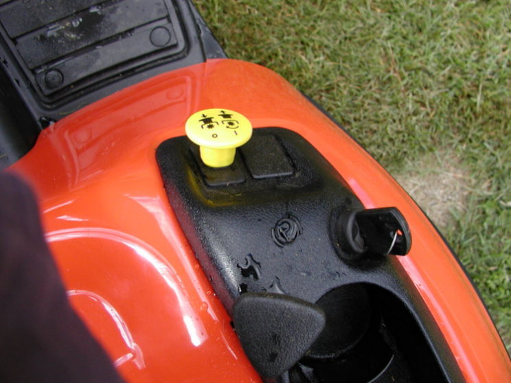

The electric pto is real nice. Simply lift the Yellow knob to engage, push down to disengage. I like this feature
