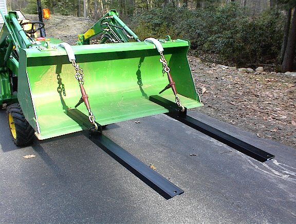

I faced a similar situation to yours about a month ago. Over the last year, I collected the brush and limbs from 30-40 trees I had cut down. The brush pile was enormous! I thought it would be nice to have some wood chips, so I rented a 30 hp Salsco chipper for a day.
The machine worked fine, but it was slow going because every limb had to be brought to the chipper by hand. Sometimes limbs would get tangled with others and slow things down even more. Finally, the limbs needed to be fed large end first, which added even more work turning a bunch of them around.
The next day I got a burn permit, and, using my homemade bucket forks with the loader on my B7500, fed fork loads of limbs into the burn pile. This worked great, was much, much faster, and I got to use my tractor! It was also less expensive because I owned the tractor but had to rent the chipper.
For fire safety, I chose to gradually feed a separate burn pile rather than burning that massive pile all at once. The bucket forks make this process fun. One should use care when feeding to avoid burning the tractor, though with the forks, that's easy to avoid.
I have attached a picture of my bucket forks. They are shown on a JD2210 but I now have a B7500. Aside from the loader itself, the forks are my most used attachment.
