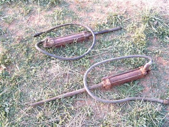

Hey Y'all!
Well, we had another successful day ride of picking up ol' stuff, lots of ol' metal parts and an' ol' Ford garden tractor and just a hodge podge of miscellaneous farm stuff. A couple of pieces we picked up were these two "single" acting hydraulic arms and my question is, what exactly does one use a single acting arm for?
thanks for help,
Steve

Most of the time, single-acting cylinders are used to lift things up such as the head on mower conditioners. Gravity is used to let it back down.

we used single acting cylinder for our skid steer loader. doesn't have down pressure, but with the geometry, it digs fine
   / single acting hydraulic arms.. #7
IN the early days FELs commonly had single acting cylinders.
?farm hand? on the early International wheel tractors was one. Used my neighbor's plowing snow back in the 70s. Annoying as all get out as I wanted down pressure a few times.

THOSE cylinders were used to raise the front mount cultivators
on a farmall H or M , they are not very big but worked great for what it was intended for.
