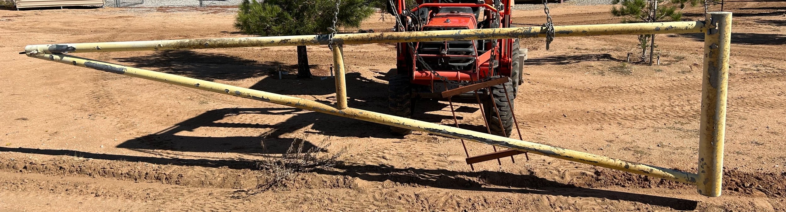

I’m thinking of adding a single swing operated gate at the end of my drive. The gate would be 650’ from power so I’m thinking Solar. I salvaged a “gate” from a school project so that part is determined. It’s a single arm pipe gate that’s 17’ long. It’s one long pipe rail top with a diagonal pipe support.
I’m guessing 200 to 250 lbs but little wind resistance.
Any suggestions on what solar operator would be best?

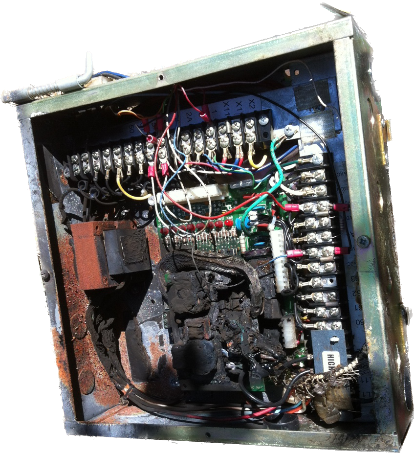

I never used a DIY opener but had enough issues with two dealer installed systems that I was glad I could just call them- nearby lightning strike, snake shorting out the control box circuits, condensation rusting the roller chain... There's a lot to go wrong.
If I were going solar though, I'd put some thought in the gate bearings. Rusty shaft in a rusty hole is sure to burn more juice. And an out-of-plumb pivot axis.
edit: fried snake-

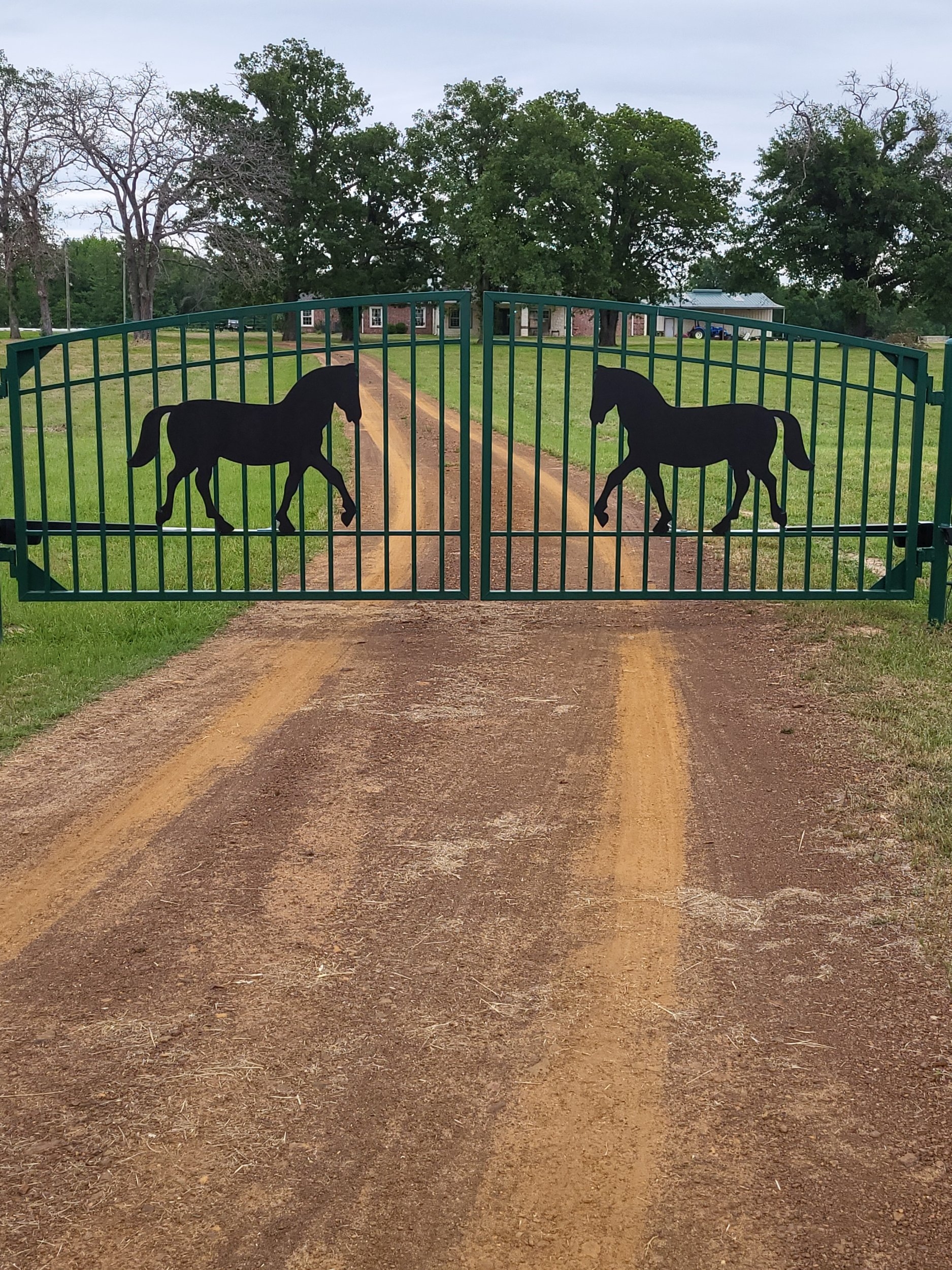

We have USAutomatic Patriot openers on our gates. So far, they have been trouble free, sometimes cycling 10-12 times a day. Before and after painting. The solar panel is mounted off to the right.
Full disclosure, they are not low cost. But they were half the cost of the Liftmaster system the installer quoted.
