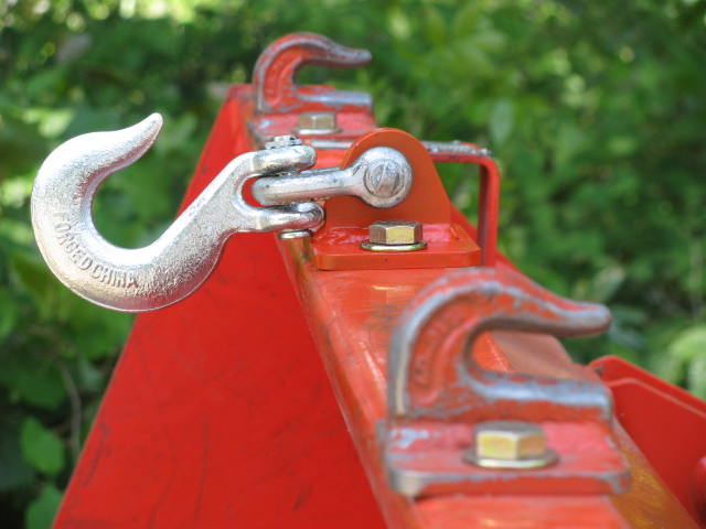

What size chain have you guys found works best with welded hooks on your CUT's buckets?

What size hooks do you have??
You have to match the chain to the hook:thumbsup:
3/8" hook.....get 3/8" chain
5/16 hook....get 5/16 chain
you get the idea, unless I am mis-reading your post??

I guess I should have asked what size hook you guys are running. Is 5/16 enough or should you go up to 3/8 hooks?
   / size chain for bucket hooks #4
Get 3/8" weldable grab hooks (pellican hooks). The 3/8" hooks will work with both 3/8" and 5/16" chain. (But not the other way around.)

I did as stated earlier and used 3/8" hooks and I usually use 5/16" G70 chain. I preheated the pelican hook before welding and I used 7018 rod.

I have Ken's Bolt On Grab Hooks on my bucket. Great product.
Ken only offers 5/16" Grab Hooks because 5/16" hooks are a sort of universal size.
5/16" Grab Hooks will hold 3/16" (sort of), 1/4", 5/16" and 3/8" chain securely.
5/16" Grade 43 chain is likely what you want. With a compact tractor you will lose wheel traction before you can stress 5/16" chain.
3/8" chain gets awfully heavy working with it during a hot afternoon.
Both Lowe's and Home Depot offer a box with two lengths of 5/16" Grade 70 chain with 5/16" Grade 70 Grab Hooks attached to both ends at a very good price.

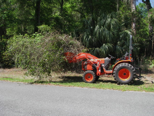

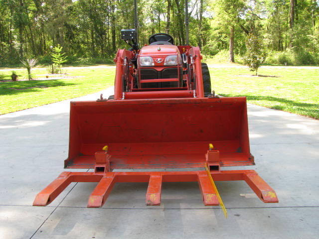

I once damaged 5/16" chain when I towed a huge (1000 pounds) pile of brush about 3/4 mile over a rough, paved road to a burn pile; several links under the pile were considerably abraded by the road surface. Cut out damaged links with a Sawzall and rejoined the two undamaged pieces with a clevis connector. After this experience I make smaller piles and move them with Payne's debris forks with the bucket raised. Often cannot see forward through the load, so drive in reverse.
