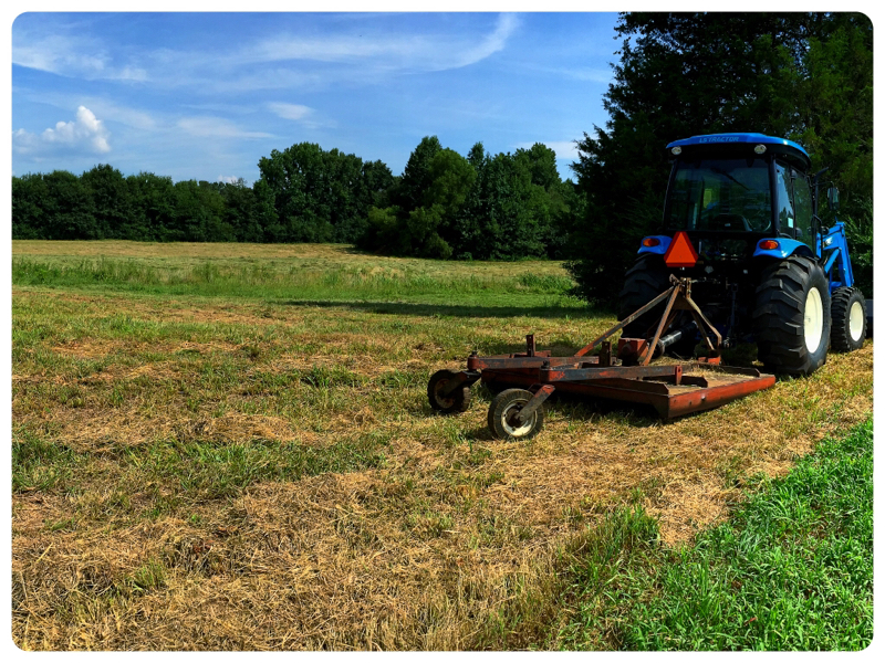

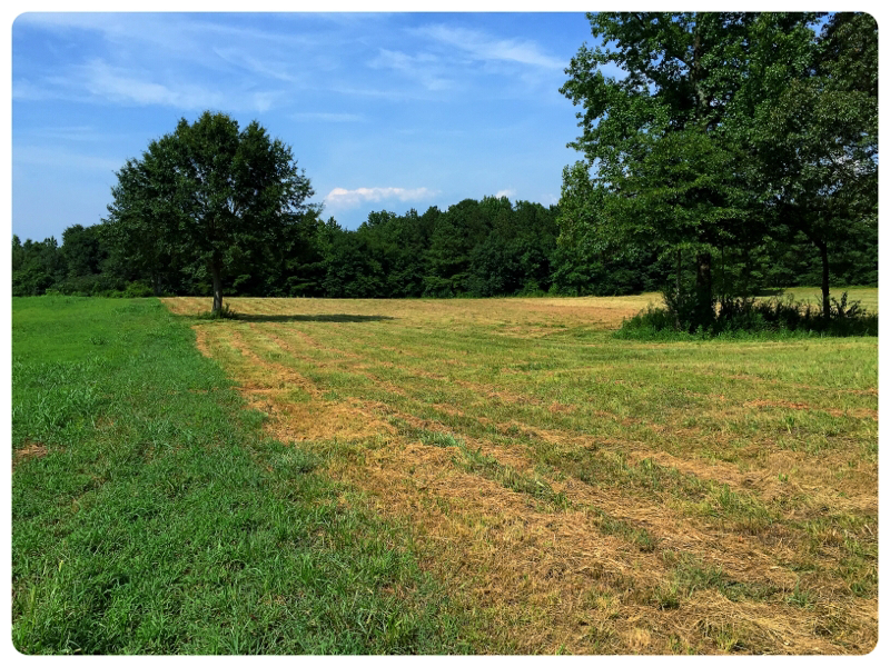

After cutting about 20 +/- acres with my father in-law's "seasoned" 6' brush cutter, I'm ready to make a purchase. The tractor, BTW, handled his cutter and mixed terrain pastures very well, and the 16x16 PS transmission made it easy to find a comfortable speed and make directional changes. Background: A local vendor/manufacturer has medium and heavy duty cutters in 6-7-8' widths, plus dual spindle 8' & 10' cutters that can handle 1.5 - 2" diameter brush. They also either manf. or distribute flail mowers, however I'm not sure yet what size or configuration knives (hammer or T) or cost. Also shopping everythingattachments.com and agrisupply.com for flail mowers.
Option #1: Brush Cutter -- I kept thinking how nice it would be to have a wider cutter, but the local vendor thinks their HD 7' cutter (~$2.2k) would be too heavy for a XU5065 in terms of lightening the front end when encountering things like ditches and steep grades. They think their medium duty 7' ($1.9k) would be fine weight wise, but if I'm giving up the HD capacity, might as well consider options like the more compact dual spindle ($$) and flail mowers. Can't justify the expense of a 12' bat wing mower, but that would be nice.
Option #2: Flail Mower -- I like the idea of the flail the most... more compact, lighter, safer in some regards (won't shoot out rocks and debris, knives can deflect over uncuttable objects). Most of all I like the beautiful cut that mulches and minimizes windrowing. Also knives can be replaced individually rather easily & inexpensively. However flails are a bit or a lot more expensive vs. comparable width rotary cutters depending on the manufacturer, can't handle large diameter brush, and since they are so compact I'd lose some ability to back under low hanging limbs and into other tight spots.
Any recommendations or experience with this size and/or model tractor?
