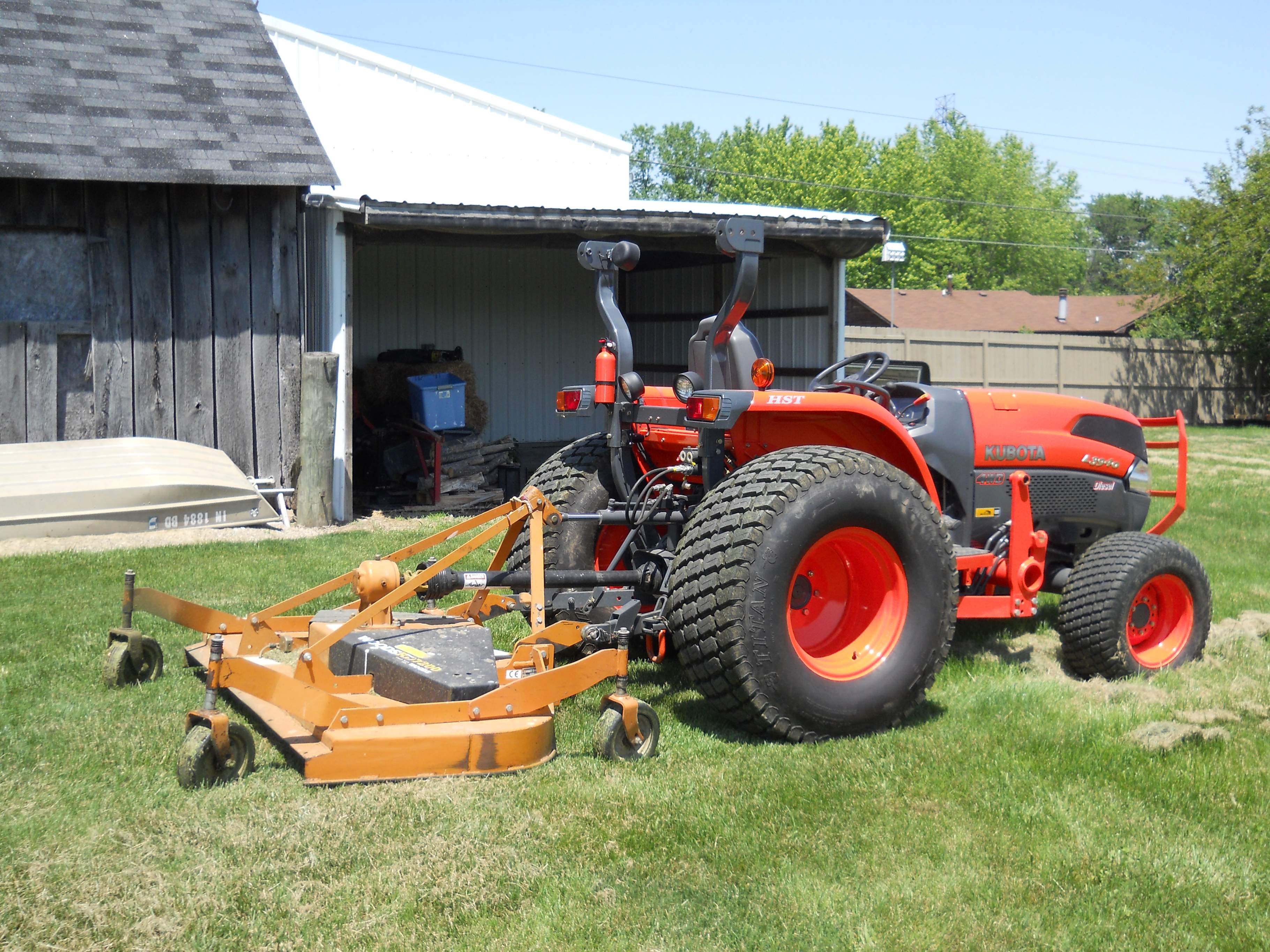

I have the Woods RD7200 (6' rear discharge). As 94Bullit mentioned, I ran this on my Ford 8N for years, could bog the engine down in 3rd gear if I did not mow often enough (3 weeks between mowings), would have to step down to 2nd gear to take care of business. I have used this same mower on my L3940 since 2009. The L3940 has excess power for this mower, even if I only mow one every 3 weeks. You WANT the 6' because it is wider than your tires. Philip.
