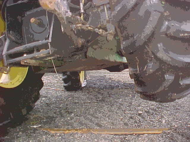

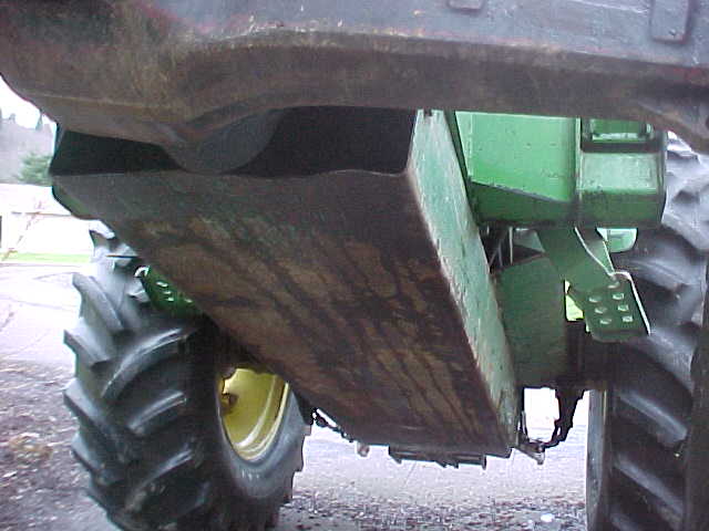

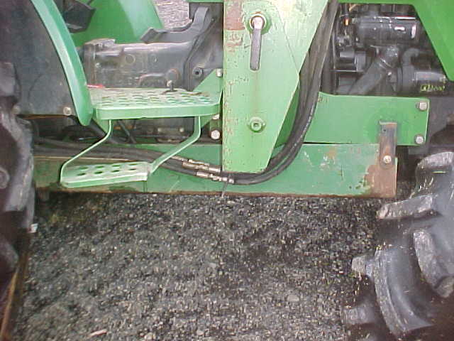

Someone asked for some pics of a skid pan and I can't find the thread it was in. So here you go, hope you can make out my pics. I can take more of any special place on it you might want to see. And yes, I did notice that the left front is a bit low, but it has most of sthe weight of the tractor on it so I could get a better pic.

Hey Randall...
Nice job!
I see ya were a little late though, for your RH step... /forums/images/graemlins/blush.gif
(mine is slowly getting that way.../forums/images/graemlins/smile.gif)
   / skid pan #5
That is sweet & simple. You might consider removeing the metal straps for the step and use some wide belting, this will alow the step to move some with out bending it.
   / skid pan
Good idea, the other side is sayed back even more. I should have just cu6t them off all together, I really don[t need them, at least for now, will be a day though.
   / skid pan #7
Do you work your equipment or what!! /forums/images/graemlins/grin.gif
I need one on mine. i have been studying how i want it .
Thanks for showing yours gave me some more ideas to consider!
