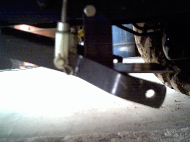

Today I built a skid plate/ guard for my 2210. I have read quite a bit about people wondering how to do it. This does have to be removed to use my MMM. However. I just use two 1/2 inch grade 8 bolts to hold it in place. I also welded a lug on each side to make contact with the frame rail to keep it from pivoting on the bolts.

That’s just what I needed “before” I went over a rock that hit and split my filter. Good idea I may do the same.
