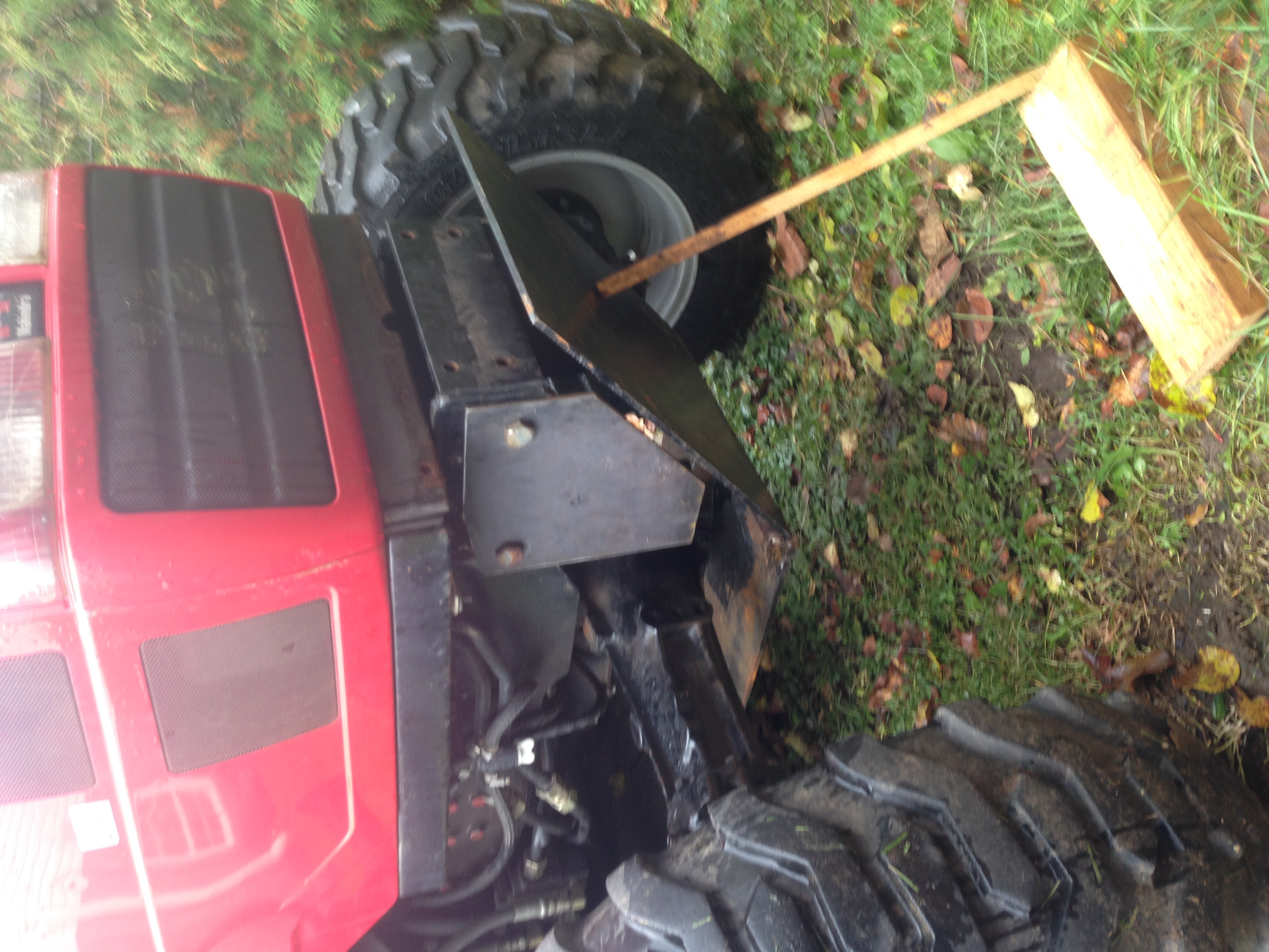

It's been a while since I've looked at that post, not real descriptive or helpful. I need to drop the plate and clean out the junk that accumulates in there and try to do a little better explanation along with some more pics if you like. I really only had 3 places to locate a "crossmember" and used 3/8" X 2" bars running parallel with the tractor in between these 3 x-members.
   / Skid Plate?? #10
My skid plate is made of 1/2" thick steel. It would be rather heavy to take off without a jack or some other method of lowering and lifting it when I need to do maintenance. So the guy who designed and fabricated it for me made it in two pieces. The smaller front piece is more likely to be removed for regular maintenance. This is held on with 2 bolts near the front of the piece. The rear of the piece is held on by a tongue-and-groove section that slides on to the front of the larger rear piece. Remove two bolts, and the front piece slides off and is light enough to handle easily.
