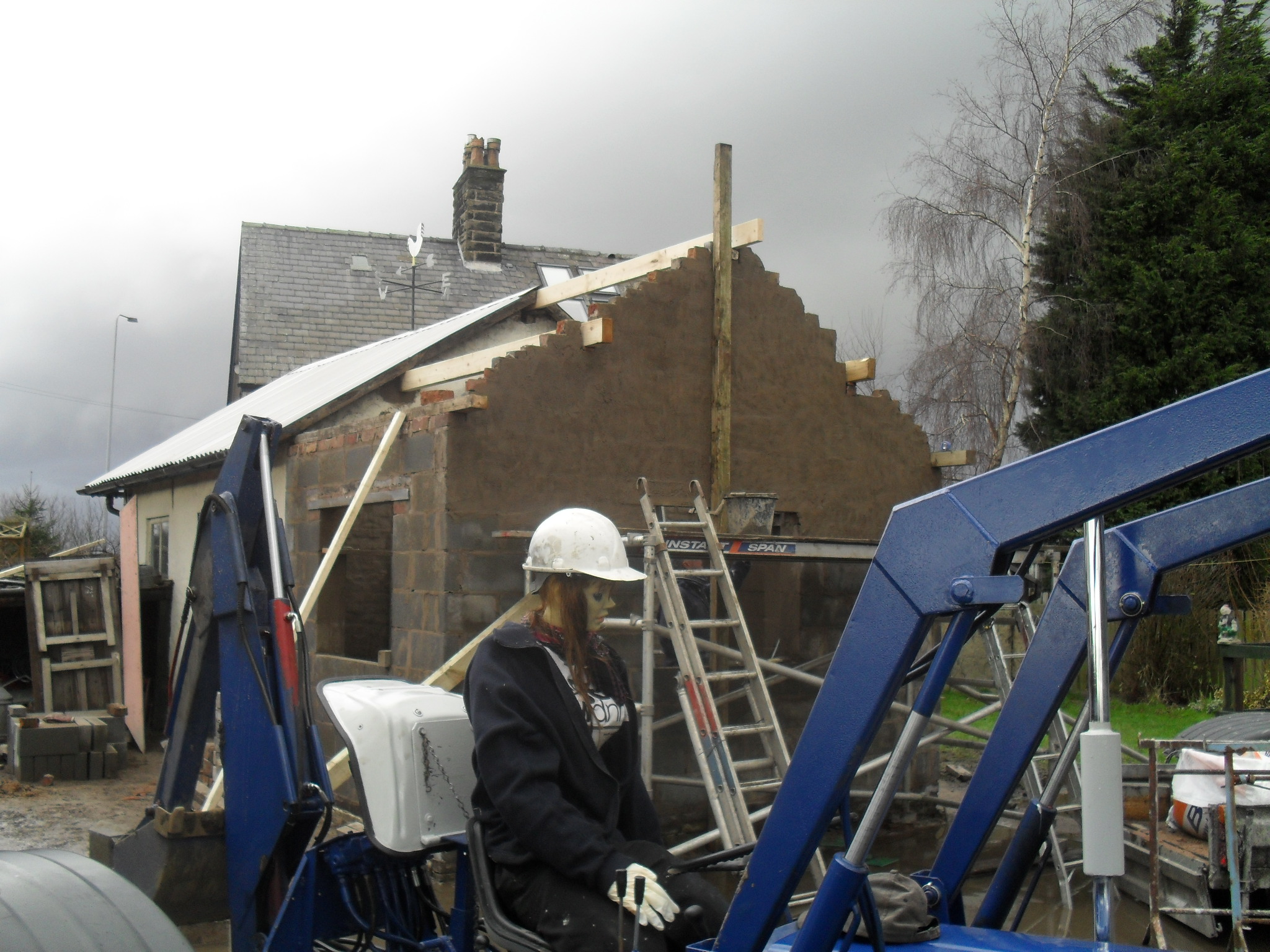

I welded two extra peices of pipe on the arm to run the pipes through, you can see them in this picture.
Maybe you could fix some pipe underneath to run the pipe through and protect it and keep it tidy:)
