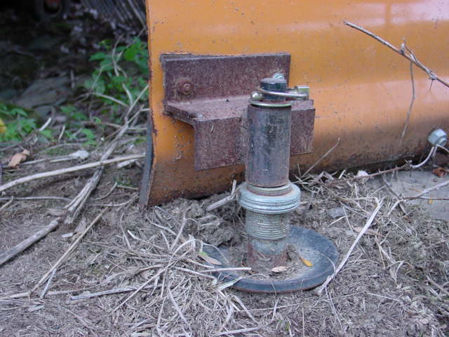

Here is a picture of the ones I made.

Nice Job.
Egon /forums/images/graemlins/grin.gif

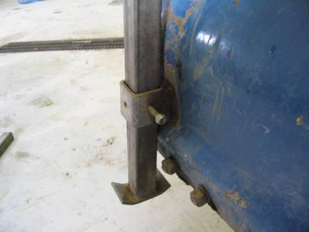

I took a pic of mine this morning. I can't remember why I had them dropped all the way down /forums/images/graemlins/confused.gif, but it must have been for something...
