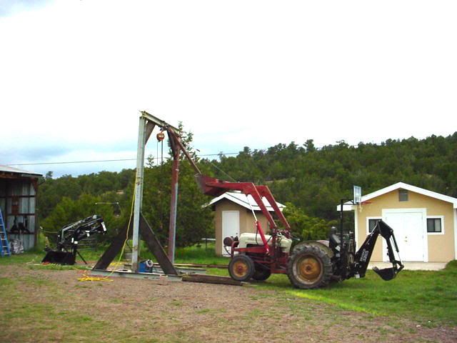

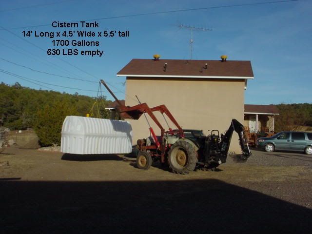

These are some old pictures I have using the boom pole bolted inside the old trip bucket, So I know the pole will not bend or break off under heavy load.....

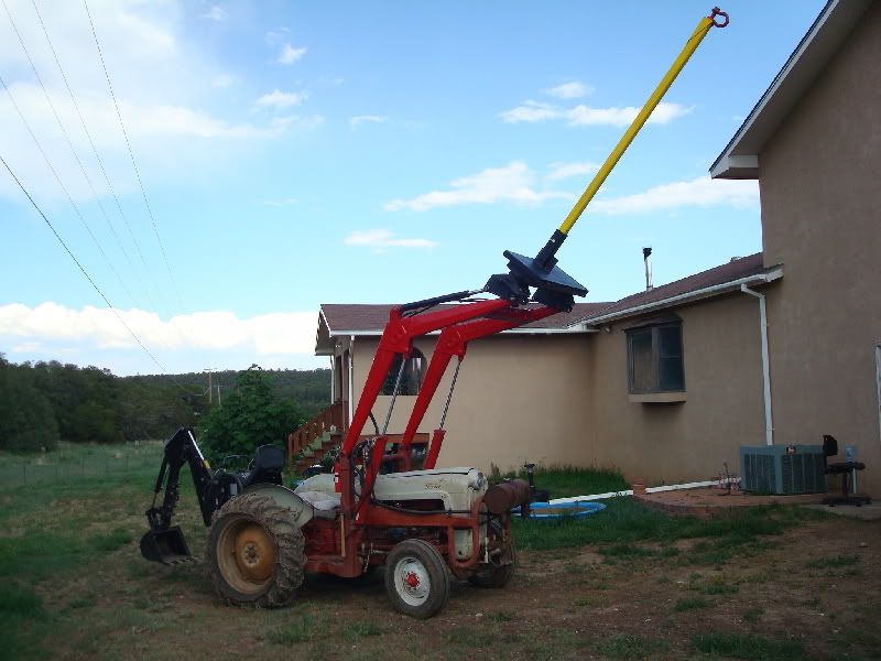

I made a little more progress on the Skid Steer Adapter plate with Boom Pole. First pic is the finished adapter plate all welded. It's been test fit to the tractor and lucky me it fits like a glove. The next step was to cut a 5/8" wide slot about 10" long through 3/8" thick plate. I did that with a 4-1/2" angle grinder with a metal cut off blade.
After the slot was finished, I welded the boom pole receiver to the plate. While that was cooling off, I wire wheeled off all the rust from the boom pole and primed it, let that dry, then applied the finish coat.
Well it's almost done, I may weld on some backing bars behind the receiver to reduce the chance of the plate bending, then paint the skid steer adapter plate and call it a wrap.

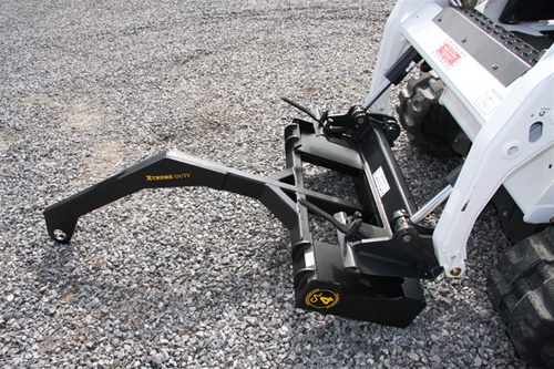

Markham makes a nice boom QA like JJs you might look at. I had them lenghten mine. Surprisingly cheap - I couldn't have built it much cheaper (even if I could build... )

I finished it up today, slapped on a coat of flat black, slipped the boom into the receiver, slid in the locking pin and that's that. It won't get that much use but it sure will come in handy when I need it for construction of my metal building. The out of pocket was just right for this sort of thing, total cost was 4 cans of paint, all the plasma cut steel was in trade for a little of my time.
For heavy lifting a cable is attached to the FEL arms and connected to the clevis at the tip of the pole. Thats what I used to do when I had the pole bolted to the inside of the old bucket as seen in the last pics of the first post.
