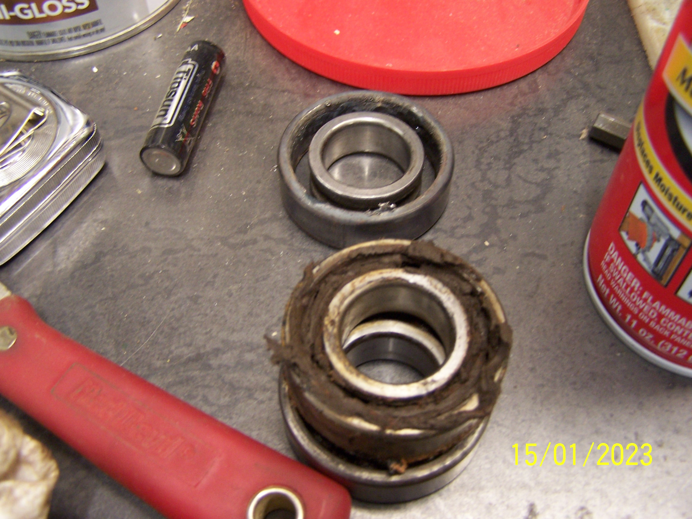

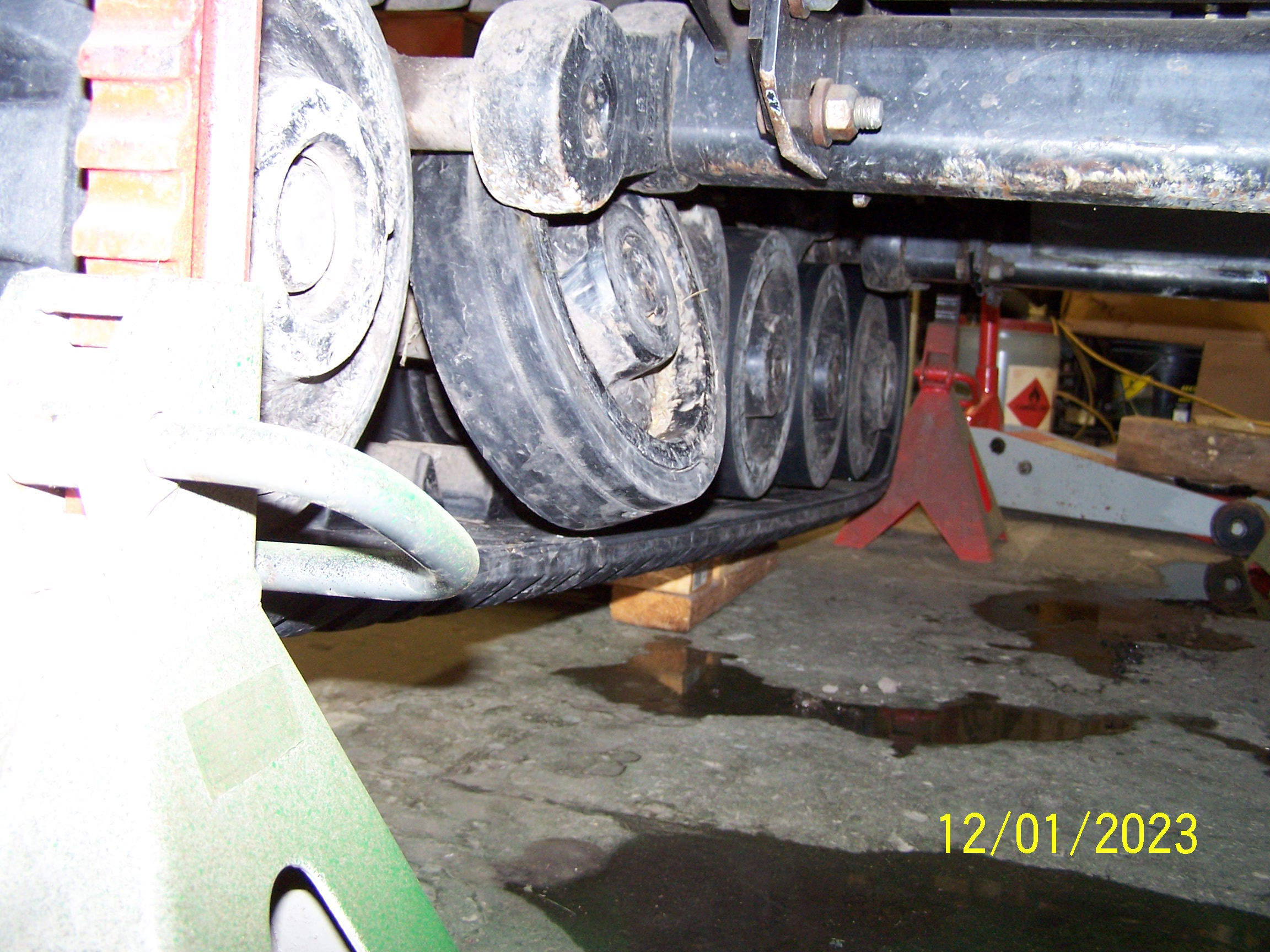

What's your typical bearing life hours? My PT30 has 980 hrs. & needs over half of them changed.

Tracks are good & the front & rear idlers are good, just the bogies that are bad. The seals must be crap & let water in. The bearings aren't sealed.
   / Skid steer bogie wheel bearing life. #4
would have guessed bearings in this application would be sealed, if they are not does it have a grease nipple? I would use sealed and de done with it
I would have thought sealed bearing would be the way to go. I bought 10 sealed ones to put in & 10 originals.
I doubt if I'll put enough hours on it now to have to change them again, old age is creeping in.
   / Skid steer bogie wheel bearing life. #6
His rollers are a different setup from mine but my Kubota skid steer and cat dozer both have oil filled rollers.
