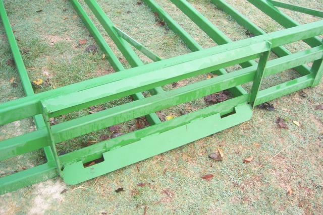

Need one for my forks, should I build or buy? 1/4" or 5/16", I lift more than I should, also most don't list my tractor-3215 Mahindra, think bucket mount is same as Bobcat? Thank You Aaron :confused: :confused2:

With th QA already on the tractor just build what you need on the forks. Its pretty simple. I built one when I made my hay accumulator ... I'll try to get a photo of it today.

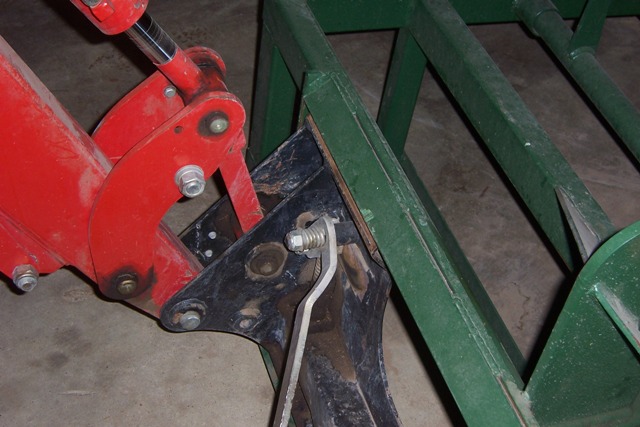

Here's a couple pictures ... the set up is the same for my 10 bale accumulator and my 10 bale grapple.
First picture is the accumulator ... top and sides are 3/8" by 2" material. The Bottom is 3/8" by 4" the slots on the bottom are 1.5" by 4.25" ... both the top and bottom are at the same angle to match the QA on the loader.
Second picture is the grapple hooked to the FEL. Hope this helps. If your asking yourself how strong is this ... the grapple weighs about 750 lbs ... my square bales about 65-70 lbs so together it holds 1400 lbs or so bouncing 10' out in front of the FEL going across the hay fields.

That the best thing I've seen to get my head into what I need to do! Just looking at my bucket, I couldn't seem to get an idea where to start. Great help! Thanks!!! :thumbsup:
