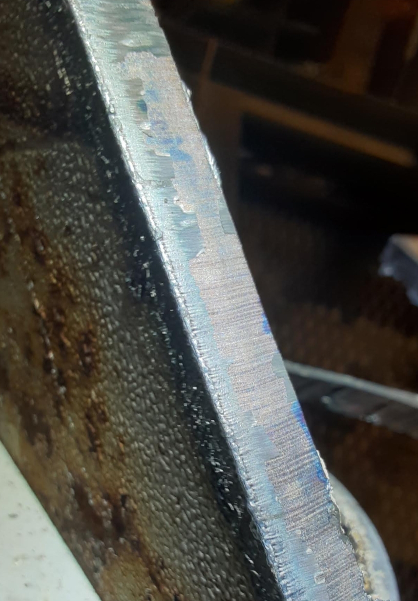

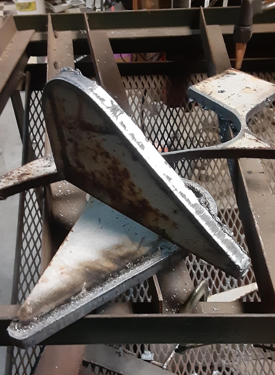

For low quantity bracket needs and such I made this many years ago and it has certainly been worth the investment in time.
Figure out what shape you need.
Make a template out of something, wood in this case.
Fire up the torch and cut it out.
Very little clean up needed, no grinding, maybe a little sanding on the edges.
