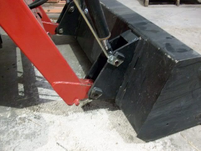

I am going to start building my quick-tach adapter for my pin-on style loader tomorrow. I am finding what seems like a discrepancy between the SAE standard and what many companies and TBN'ers are posting for the dimension.
On the tractor side, the dimension from the very top tip of the tractor adapter to the point where the 120 degree angle starts for the bottom pin flange is being listed at 16" by TBN members and several attachment companies. The first file below is a drawing that has been posted here before and shows that dimension at 16". But compared to the SAEJ2513 standard, 16" should be too big and not fit.
Link directly below shows 16" too.
Will it Fit My Machine
url
On the SAEJ2513 standard, the drawing shows the dimension on the implement size as being 15 7/8". The second file below is the SAE standard.
I am going to find a skid steer in town to measure tomorrow, but right now it is confusing the heck out of me:confused:. I the 16" must be correct since mwb specs it in his prints here, and his setup works, and the 16" dimension appears in so many places.
http://www.tractorbynet.com/forums/build-yourself/141029-tractor-side-shuttle-shift-quick.html
Any input? What is this dimension or your loader? Thanks

my build was done using the specs and I also used my neighbors bucket for fitting / squaring the tractor side up. I made the tractor side slightly loose - a lot easier to add material than to remove it from the entire fixture. I think I put a 1/16 steel sheet between the (tractor side) QA and the reference bucket - after welding, paint, dirt, there is absolutely no slop at all and I never have a problem latching.

16"will work fine. The pins that engage the implement are tapered so that it draws the implement in tight when engaged. If you want to go 15 7/8 on the tractor side, and 16 on the implement side, it will work fine.

Thanks for the replies. I ended up buying a Berlon universal mount plate to use as a guide. My local farm/home store had them for $105.00.
I have my latchboxes almost completed, the next part is to finish building my lock pin linkage.After getting this far into the project, I would not recommend trying to build an adapter without a plate or another bucket to use as a fixture.

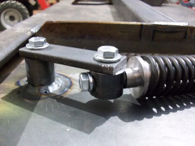

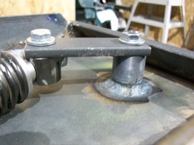

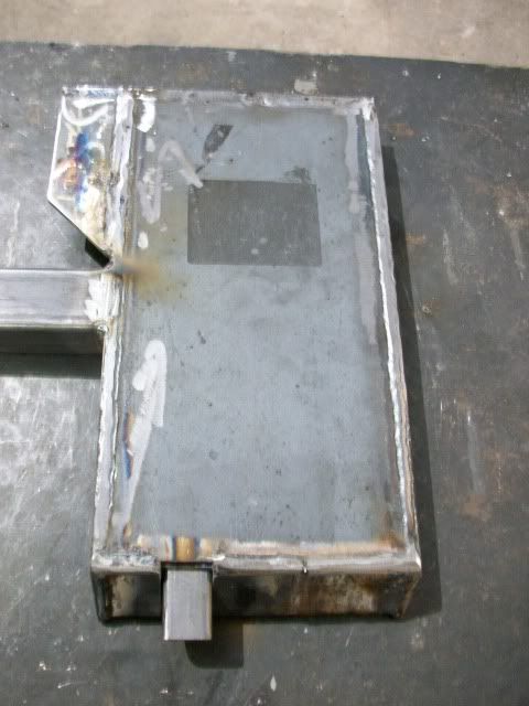

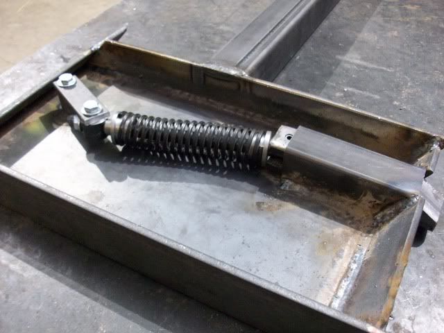

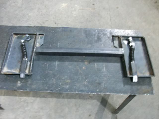

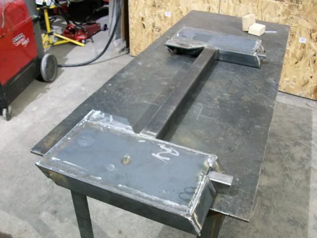

mwb,
I am not using your plan but I have referred to it and your posts numerous times. Thank you for posting that information.
I don't have "in-process" build pictures, but here are a few of what I have done at this point. What I have left to do is:
1. Make the latch handles and their stops (need to go to the metal store first).
2. Add grease fittings to the pins.
3. Cut off my bucket brackets and attach to the QA assembly.
4. Disassemble, de-bur and polish edges, clean up slag, and prep for paint.

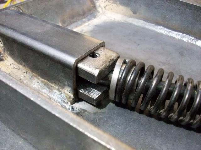

The latch boxes are made from 1/4" flat. The lock pins are 1 1/4" solid steel and slide inside 1.5" x .120" square tube. The cross-tube between the boxes is 2" x .120" square tube. All the framework was welded with E7018 1/8" DCEP 110-135A. I was going to TIG the whole thing, but running 230A at 20% duty cycle was going to take way too long.
The latch mechanism I built from scratch using 1/2" and 1" cold-roll stress-proof round bar with some 1/4" x 1" flat for the levers. I machined all the parts on my lathe and mill. The springs came from an industrial surplus store and are approximately 1" ID, 1 3/8" OD, and the wire is 3/16" diameter.
The bosses that serve as the pivots for the lever bracket are machined to .280" in height to allow the bolts to tighten and allow some clearance for movement. The 1/2" rod that extends from the lock pin to the lever assembly is drilled and tapped to 5/16-18 on the lever end, and a simple lock-washer and bolt act as a retainer. The lock pin side has a 5/16" roll pin to hold the 1/2" rod to the pin. I TIG welded the main pivot pins to the latch boxes.
The last major design step is cutting the brackets off my old bucket at the proper length/angle so that my attachments can be in a full range of motion, especially when the loader is all the way down.
