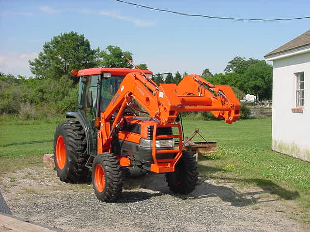

I am also waiting on a new bucket for my 4330. Its a quick attach heavy duty and the dealer just said that it will be here next week. Here is a pick of what I picked up so far. Hopefully next week I can use the loader.
