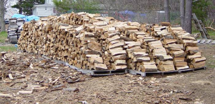

i haven't had chance to really try mine out yet.
i just finished bucking and splitting next winter's wood.
soon it will be time to replenish the log pile
   / skidding winch #8
You really need to build yourself a woodshed. Nice looking pile.
