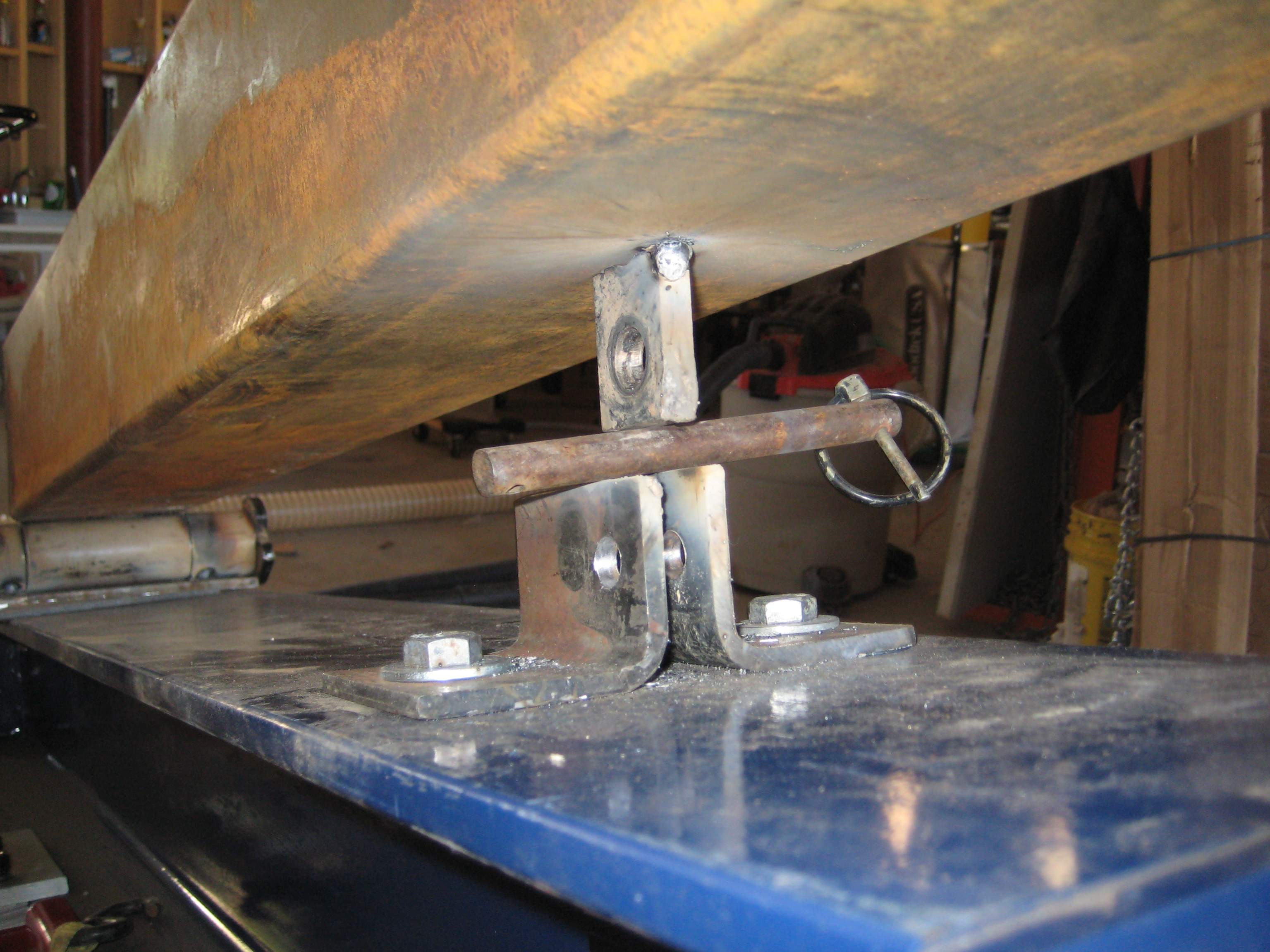

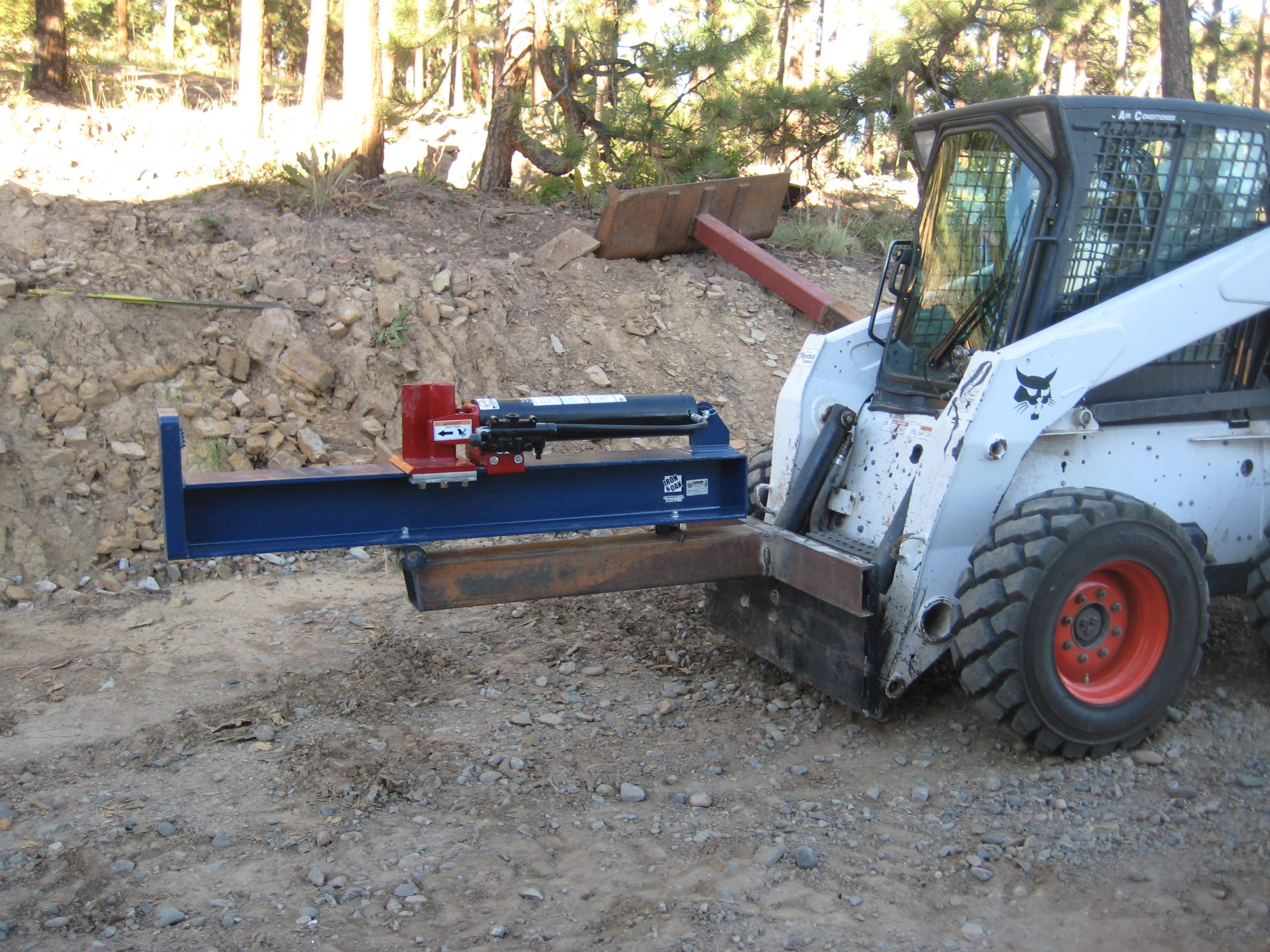

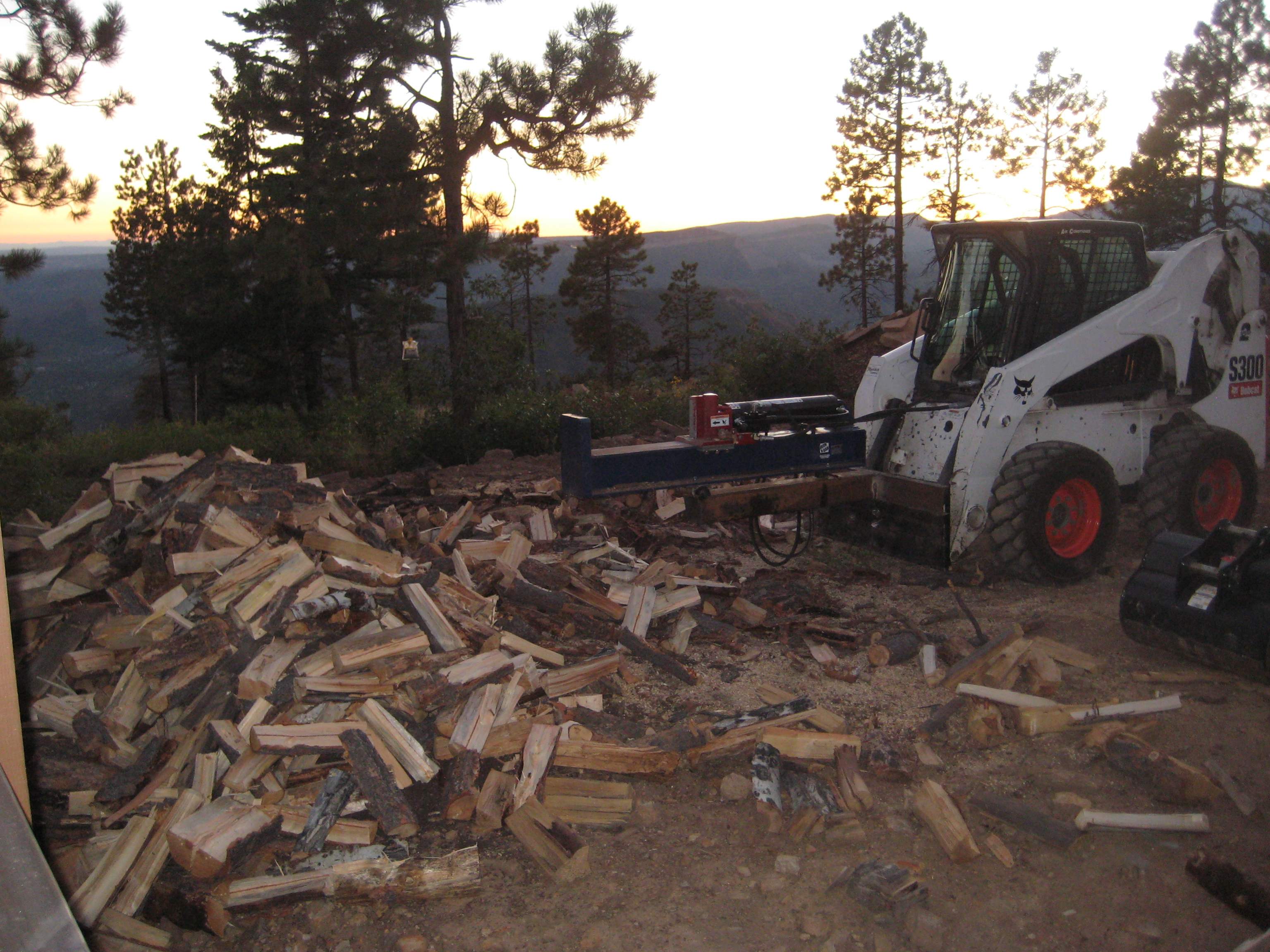

I just got done testing out the new logs splitter and it rocks!!
Here is the story:
everything painted blue, the ram, the valve, the splitting head all came from Iron and OAK log splitter manufactures for $750 delivered. IT has an 8" i-beam and 5" ram

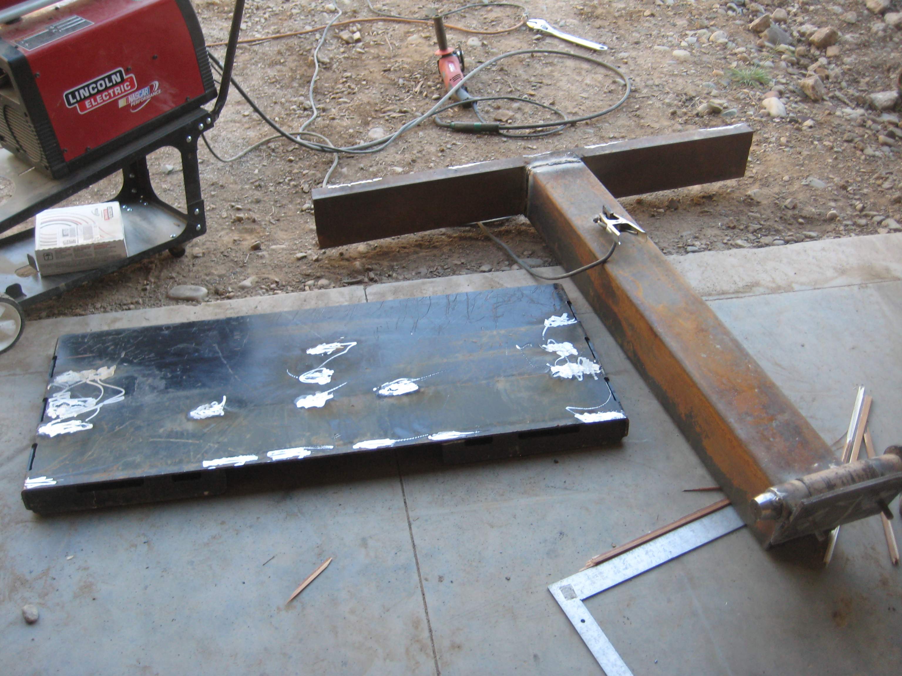

I had the bobcat plate and the tube steel at the barn.

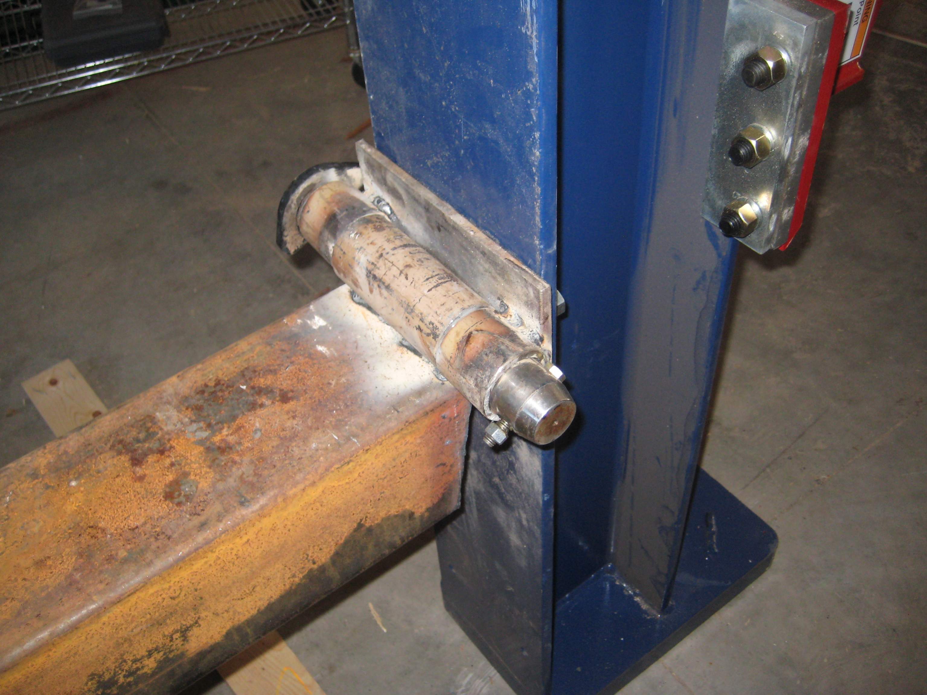

the hinge is a piece of 1/4" wall 2" diameter pipe with a excavator bucket pin connecting it together.
Once I had the other attachment cut from the bobcat plate, I had about 4hrs of fab time.
I had 2 - 12' hoses made to attach the bobcat to the splitter and the machine works great.

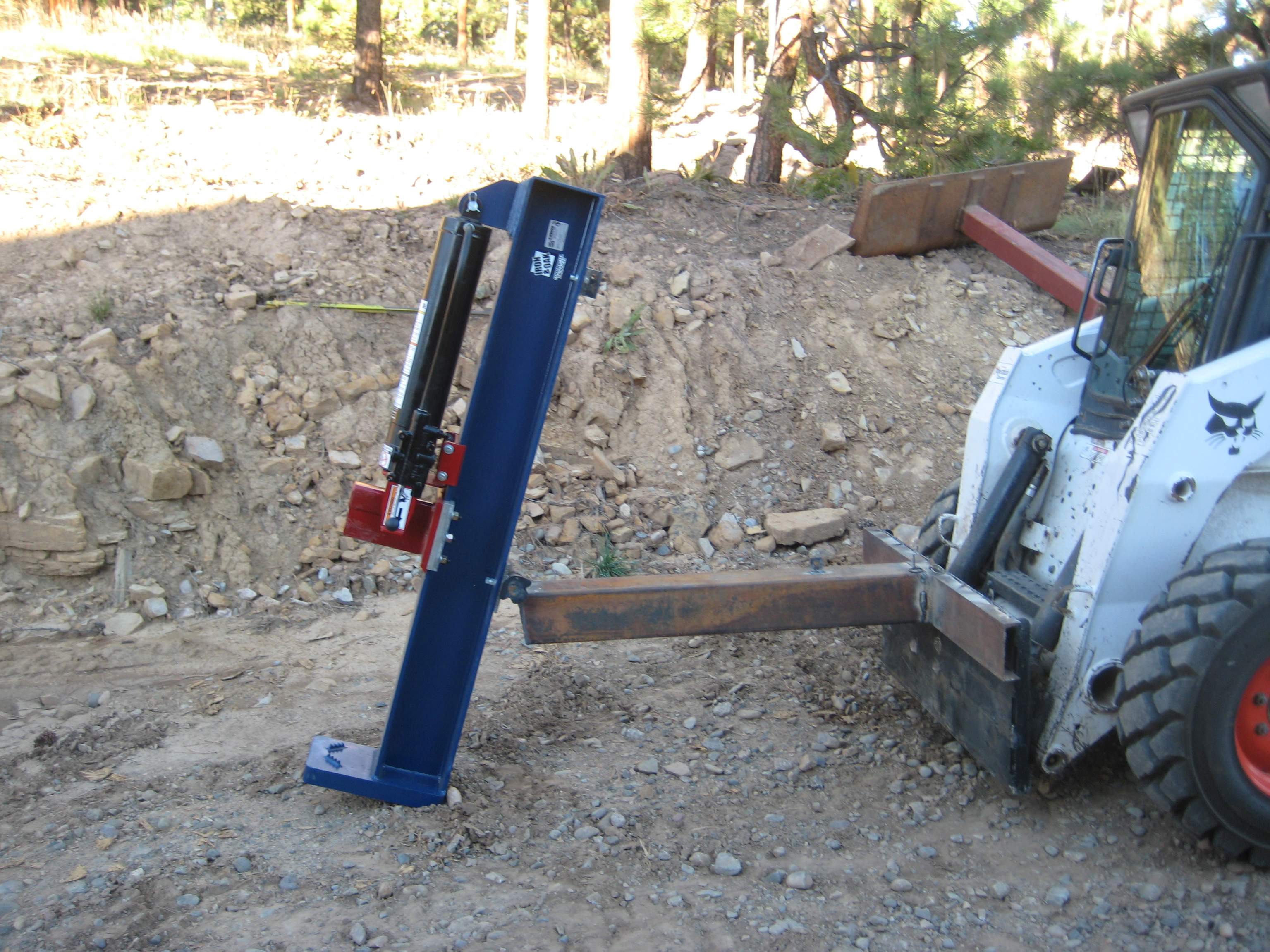

Install a gusset from the bottom of the bobcat plate to the underside of the 6" rusted tube. When you travel with the splitter hooked to the bobcat the splitter bounces.
rotate the valve to the top of the ram so that splitter can be operated from both sides.

I recently set an old gasoline powered splitter with a tired/shot motor up on my skid steer and like it so far. I have been thinking of turning it upside down and just using the control valve in the SS and splitting from the cab. Be nice to do the oversized pieces without the wrestling match. Mine will go vertical also so that at least cuts down on lifting.

update.
I installed the # 12 hose from the snow blower. The splitter operates awesome. I ran the bobcat at idle speed, 1000rpm about. when the auxiliary hydraulic is engaged the bobcat engine doesn't change its sound, with the other hoses (small diameter) then the aux. hyd was engaged the bobcat motor changed its sound, like it was under a strain.. I ran the splitter with the new hose, 2 hrs at 1000rpm the outside temperature was 70degrees, the hydraulic temp never went over 120degrees or something like that. With the smaller hoses I ran the motor at 1500rpms to get ideal same ram speed, it was 70 degrees out and the hydraulic temp went as high as 145 degrees, there abouts. With the larger hoses, I cranked the RPMS to the max 2400, and the ram was at an extreamly unsafe speed so I backed down to an idle
Larger hoses less friction, less heat, saves fuel and wear on the machine.....
