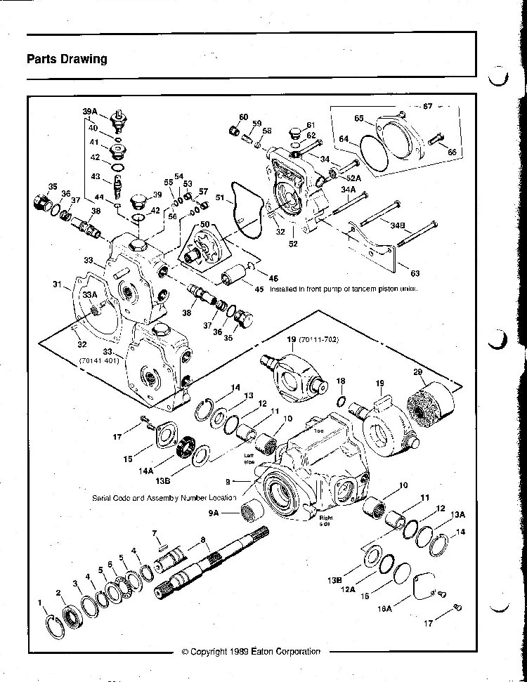

I do not have a hyd. schematic. The operator manual has very little info in it. I do have a schematic of the pump itself. I have scanned it in. There appears to be 1 pump with 2 seperate sections. There is seperate fluid reservoirs for the implements and the drive system. There are 3 foot pedal valves for the boom lift, bucket tilt, and grapple fork. How everything is connected to the pump I am not sure.

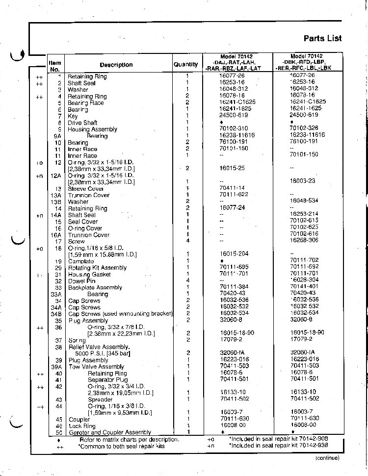

   / skidsteer leak down
2nd page

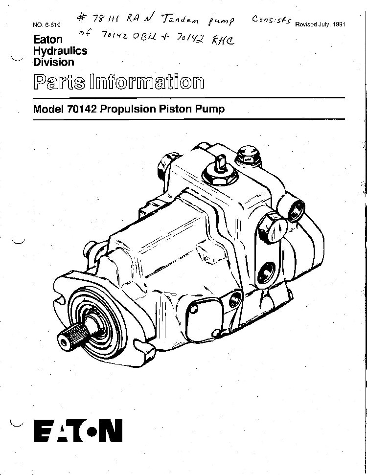

3rd page

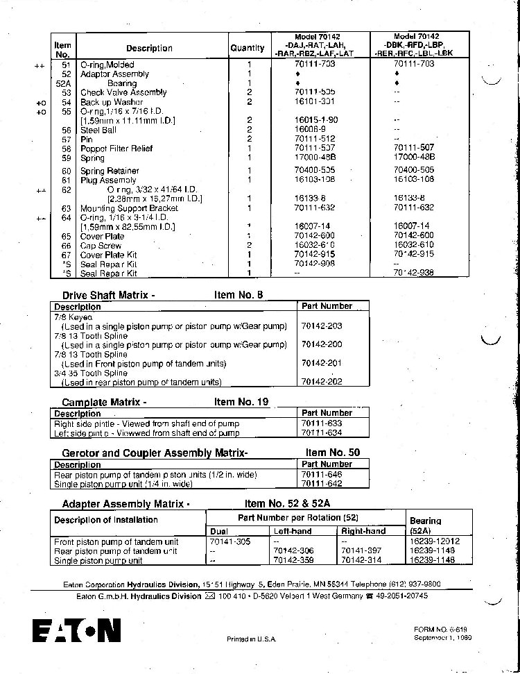

4th page

O.K., this could be difficult without a hyd. system schematic but let's give it a shot anyway. It appears that the scan shows the pump for the drive system, which most likely feeds two hyd motors that drive the chains for the left and right wheels respectively. Now at 20 hp it's entirely possible that the charge pump also provides power to your implements as well as the piston pump for the drive, however, with two seperate reservoirs on the machine it leads me to believe you have a seperate pump for the loader and possibly another pump for an aux circuit to the grapple (by the way, is the grapple a seperate attachment that mounts in place of the bucket?) If you have a complete parts breakdown for the machine does it show any other pumps? But all that aside, the main question is do you have self leveling, in other words, when you have a bucket full of dirt and you lift it to full loader height does the bucket atomatically tilt forward to keep from dumping the dirt on your head or do you control that yourself with a combination of lift and dump control?
