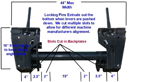

Someone here once posted a sketch of the actual skidsteer attachment dimensions. I thought I saved it, but alas, no. I tried a search to no avail.
Can anyone help?
/ skidsteer quick attach dimensions #2
The general width of a modern quick tach measures 44" from the outside to outside. There should be two levers that each push one pin down out of the bottom of the Quick Tach (total = 2 pins). The pins measure 32" on center. These pins line up with slots in the attachment. When the top of the Quick Tach engages with the lip on the top of the attachment and the pins are slid down into place, you will have a positive connection
