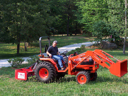

First, let me thank everyone who responded to my original post. Your comments and suggestions are greatly appreciated. Your posts and all of the other invaluable info on the forums really helped me make an informed decision. Specifically, I’d like to thank Henro, Poppa, and Bird. Your comments on the suitability of the Kubota line made me take another look at them, and helped me to settle on my eventual choice.
The new baby was delivered yesterday. Kubota B7800, 402 FEL and a five foot box blade. From the dealer for $14,850 delivered. I have a tooth bar on the way, and have ordered a post hole digger with 6” and 12” augers and a five foot shredder from TSC. Hopefully, I’ll have all the toys in one place by the end of this coming week.
While I’m very confident that I have a very reliable, hard working tractor, I’ve been disappointed with my dealer and his after-sale support. I’m getting the feeling they were only interested in collecting my check, but I’ll see how they resolve some of the problems I’m having before I post the name of the dealership. Enough now to say that about 15 minutes after I started using the tractor, I saw hydro fluid POURING (not leaking or dripping) from one of the connections on the FEL. I’ve called the dealer twice this morning and have yet to get a return call. To say the least, I’m a little frustrated!! /forums/images/graemlins/mad.gif /forums/images/graemlins/mad.gif
I guess I’ll just have to rely on the experts here to help me with my first tractor!!

Congratulations! Nice looking machine. Take a look at where it is leaking and give us a description. I know it is brand new and under warrantee, but some things are easier to take care of yourself if they are simple. Could be just a loose fitting that needs to be snugged down. If it is something bigger, let the dealer handle it. Kind of messes up that great feeling of the first day with your tractor though. I feel for ya. Just realize that it probably is a simple fix for either you ar the dealer and then you will be back to Playing. OOps. I mean working with your new beauty. Good luck and let us know what you find.

In regards to your leak, I have one as well on my new TC45. So don't feel alone! Not exactly pouring though.
*4 leaks all-together:
-One leak slowly drips from one line on the quick attach hookup to the FEL.
-Two small leaks coming from underneath the FEL Joystick from the distribution block; two of the lines there that hook into the block have the fluid seeping from around the threads.
-And one leaks at the threads on the other end of the line that comes from the distribution block and connects underneath the operator’s platform.
Hopefully we just have minor sealing and connection issues that can be easily fixed if resealed and connected, but with 12 hours on my machine and warranty I'm not about to touch it myself anymore than I have.
I've called my dealer also and he tried to tell me to check the connection the first time and tighten if necessary, call back if that's not it. I've done that but it's hard to get a wrench on them due to the other lines being in the way and at this point in time I'm not even tempted to undo those lines to get to the other connections. I'd probably just end up with more leaks.
So it's definitely going to be taken to the dealer to get fixed. He told me to bring it in and they would take care of it. I was going to try and hold off until the 50-hour service but I was using the FEL yesterday to take off the center crown of my short driveway and after putting it away for the day it was dripping even more intensely. /forums/images/graemlins/mad.gif So I'm going to do some work with it Sunday cutting some light brush and field then Monday I'm hauling it to the dealer.
It just doesn’t seem right when you buy something new and spend that much money and when you finally get it you notice little aggravating quality control issues from the manufacturer like my leaky FEL lines. I love my tractor but those leaky lines put a damper on my excitement.
Keep calling your dealer and explain to him that you just purchased a brand spankin new tractor and it shouldn't be leaking like that. Don't know how far your dealer is away but see if someone can come and fix it or pick it up and take it in to fix. Good luck MFL!! /forums/images/graemlins/smile.gif

Sorr to hear about your experience. I agree with you about the quality control on a new machine should be better. I would let the dealer handle 4 leaks on a new tractor also. I have been fortunate enough to not need the dealer yet on my new machine, but I did need to re-seat a hydraulic fitting on the loader. It won't void the warrantee unless you mar up the B-nut. But I work on Aircaft hydraulics daily and these fittings are familiar to me. Be careful when you are using yours this weekend. Lose of fluid on a tractor is not a good thing from a safety and a mechanical standpoint. Good luck with getting it squared away.

That's a very nice rig with those attachments. I'm sure you'll enjoy it. As for the fitting leaking, it's almost certain to either be just a loose fitting someone forgot to tighten or a damaged fitting from either cross threading, overtightening, or something similar. Not a major problem at all, but I know it can be frustrating and aggravating when you buy something new and it's not right to begin with. And of course, you'll need to check the fluid level when it's fixed to make sure you didn't loose enough to need to add some.

As quick as I am to name names when I recieve poor service or poor value for my dollar, I feel it's only right to mention people when they go out of their way to make things right. When I finally recieved a call from my dealership this morning, Greg Bearden of Bearden Trailer in Carrollton, Ga went the extra mile to make sure I was taken care of. Even though the dealership closes at 12:00 on Sat., he sent a mechanic to my home with a new FEL with instructions to change out the entire unit if he had to. The mechanic, Jaime, found a large burr on the face of the copper connection on the hose end. He changed out the hose, checked all of the other fittings and left me a gal. of hydro fluid evern though the levels were fine. Mr. Bearden then called back a few hrs. later to make sure all the work had been done to my satisfaction.
Unfortunately, I was not able to speak to him personally because by then I was already digging out boulders to clear a fence line on my property. /forums/images/graemlins/grin.gif /forums/images/graemlins/grin.gif /forums/images/graemlins/grin.gif
Hopefully your dealer will take care of your leaks in a similar way. Thanks to everyone for their comments. TMAC, please let me know how your situation turns out.
