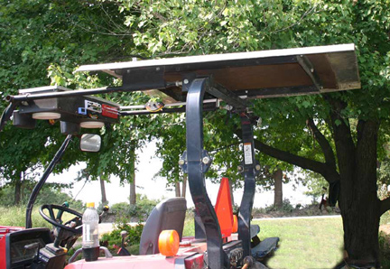

I thought that I would post a few pictures of what I have been working on. This Link will take you to My Photo Gallery in the photo section. I made a sliding canopy a while back, to shade me when I am using the backhoe. There are also two pictures of the start of my overhead console. I will add more as things progress.

Jerry that's a nice looking project. Did you come up with the idea or have you seen the design used somewhere else?
   / Sliding Canopy and Overhead Console
Thanks It's my design. I hope to have more to show, before long.

I finely got around to posting some pictures of my finished overhead console. I posted them in my photo gallery .

Very nice, Jerry! /forums/images/graemlins/cool.gif It's obvious that you put a lot of thought and creativity into your design. How close does the boom on your BH come to it? How much electrical cable flex is required?

<font color="blue"> How close does the boom on your BH come to it? </font>
It is almost as far over my head when it is over the backhoe as it is when it is over the tractor seat. I need to post a picture of the canopy slide back.
<font color="blue"> How much electrical cable flex is required? </font>
None. All the overhead radio electrical etc are stationary on the front. Another picture needed for that.
When I have the backhoe on the next time I will post some more in the gallery. For now, I have attached a picture without the backhoe on, but with the canopy slid back.
