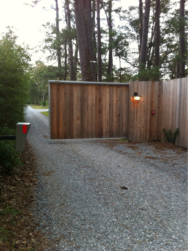

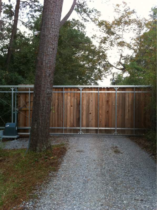

These are front and rear photos of our cantilever gate. It is aluminum with cedar inserts. We had to lay 800ft of underground conduit to get power out to it. Also has a CCTV above the gate. It Goes to a DVR at the house. AT&T put an underground line from the road to the telephone access controller. The gate itself has a 12 ft opening with a total length of 36 feet. 4 families live within the boundary of this gate so it gets a lot of use. Well worth the expense. Everybody inside Is safe and secure. No more weirdos driving into our place.

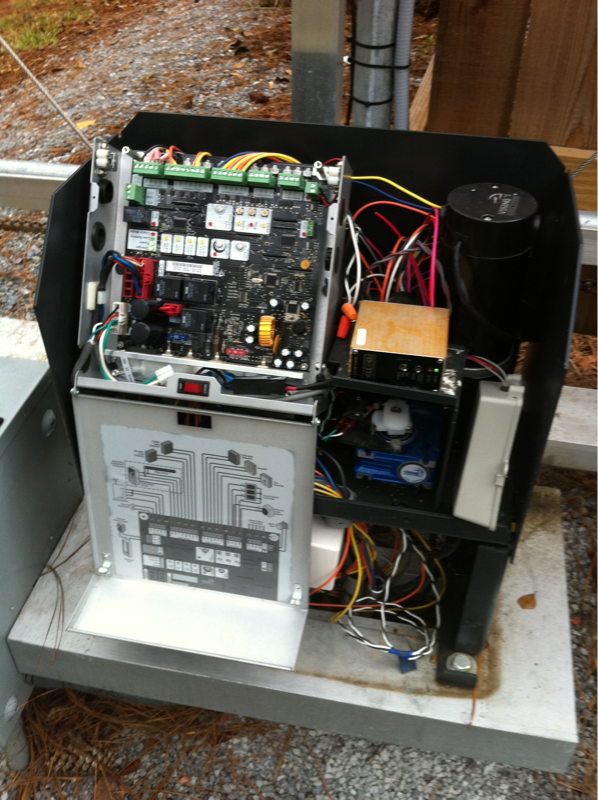

JHTFarmer,
Nice looking gate. What kind of gate opener did you use?
   / sliding gate #10
It's a Viking Access systems model L-3. Rated for Continuous operation on gates up to 1200 pounds. We have it set up with a safety photo beam, underground free exit loop, radio receiver, and to a digital (telephone) access controller.
