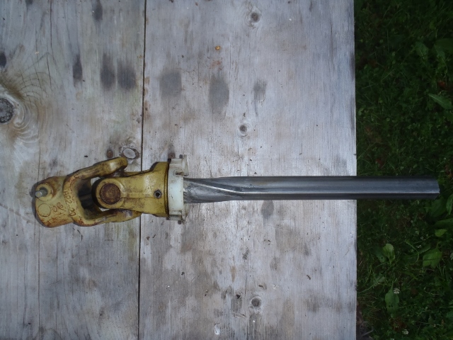

Warning - Confessional moment:
I am ashamed to admit that I have a slip clutch on my 4" direct drive chipper, but I forgot to slip it before using it. Lugged down on a big chunk of hickory - almost to a stall. Yanked the trunk out, re-fed it and shredded it, no problem, or so I thought. Later that day, when I went to separate the chipper from the hitch, I couldn't get the PTO shaft to retract enough to disengage it from the tractor. Turns out I put a 45 to 60 degree twist in the inner shaft.
Penance for my transgressions:
Now must fix PTO shaft and slip the clutch before using the chipper again.
Conclusion:
The slip clutch would have saved my PTO shaft, had I adjusted it before I used the chipper. So it's not just the belts you'll be protecting if you decide to get a clutch, but you have to service the clutch by slipping it on a regular schedule.
   / Slip clutch on a 3PTH Wood Chipper #4
Here's what it looks like:
Slip your clutch at the start of the season!

You just need a stronger pto shaft.
   / Slip clutch on a 3PTH Wood Chipper #6
Ha-ha - yes!
I was just very relieved to see that the shaft yielded/twisted, saving my tractor PTO shaft & bearings from damage.
