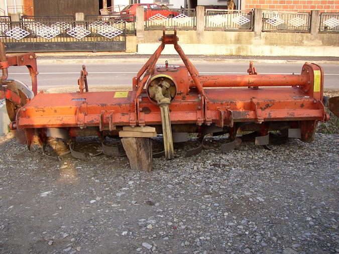

The other day I was using my father's Howard Rotavator HA on some sloping terrain. As I was going ahead, the tiller caught some buried wood and I was quite concerned (read scared shi*****) /forums/images/graemlins/tongue.gif with the stability of the tractor; but that's a future post in the safety section.
Anyway, after a few seconds of surveying the situation, I noticed the slip clutch on the rotovator just smoking in back. I quickly disengaged the PTO and when I got the unit back on level ground, re-engaged the PTO. The tines were moving just as usual.
Now, not being a mechanic, I have to wonder if I did any permanent damage to the gear box, or if the unit functioned as normal. There was a fairly strong smell while the event was happening, but that has now dissipated. My understanding is that these Howard Rotovators are built tough, but any insight into this would be appreciated.
   / Slip Clutch on Howard Rotavator HA 80 #2
Sounds like the slip clutch did what it was supposed to do. And it sounds as if you should have disengaged the PTO a little quicker, but you may or may not have burned enough of the friction material for it to need replacing. If it's still working right, I'd probably leave it alone, but you can take it apart and see if it needs relining.
   / Slip Clutch on Howard Rotavator HA 80 #3
Howard Rotavator HA 80 is not a "toy tiller". It is not as easy to break it.
Bird explained you well, and I'm curious what tractor did you use for run it /forums/images/graemlins/blush.gif

ZJ,
I was using a JD 4410. This is a 35 HP tractor. It was previously used on a Ford 3000, which I think is around 40-45 HP.
I'm not sure if the slip clutch was worn at all previously. I haven't used it since to see if it is ok, but I will be using it this weekend.
