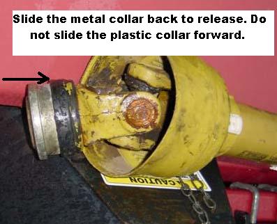

If yours has two rings, one plastic and one metal, you probably have to pull the metal ring away from the tractor. This is such a common mistake, one I made also, that I posted some pics in a thread a while back. I can't find the thread, but I did find the picture.

</font><font color="blue" class="small">( If yours has two rings, one plastic and one metal, you probably have to pull the metal ring away from the tractor. )</font>
You are exactly right, that was the problem. When I pulled the metal ring away from the tractor it works fine. When I called the company, the guy on the phone answered my question before I even finished asking it. He says they get that one a lot. I didn't point out a picture in the manual would help. They should use your picture.
