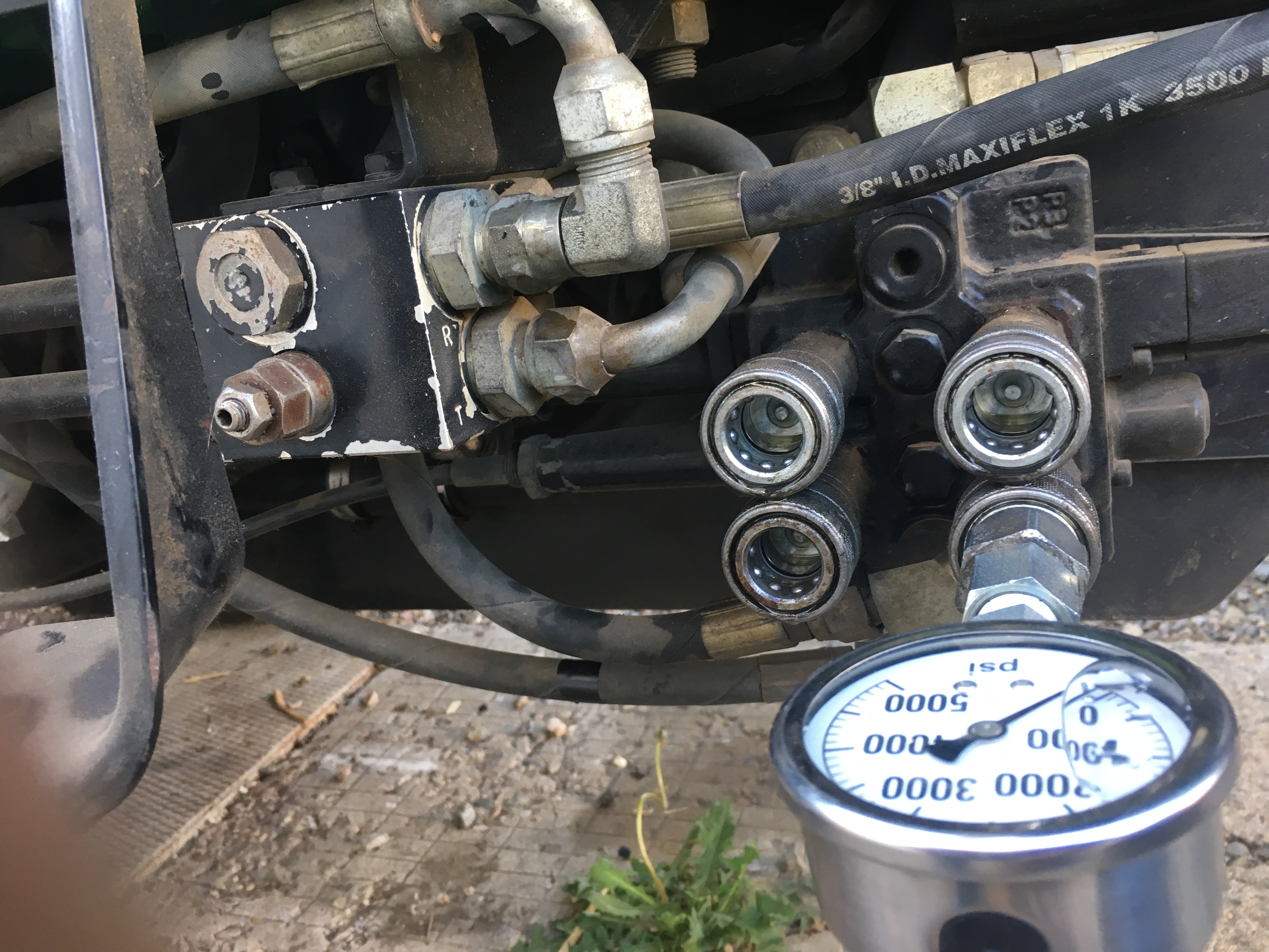

My problem is that the loader is slow and weak. It takes about 20 seconds to fully raise (should take 4) and it would hardly lift a couple hundred pounds at the pins (Specs say >2000). It also got progressively worse as it warmed up. After doing some research on here I went out and bought a pressure gauge and some fittings. In the rear remotes the pressure gauge shot up to about 2500 psi and I heard the relief valve whine so that was all good. When I put it in the loader quick disconnects I got about 600 psi in the raise/lower ports and about 650 in the tilt ports. I also did my best to test the cylinders on the loader but since they were only getting 600 psi I figured that they aren't the issue.
The pressure from the pump goes into a distributing block and then into the loaders directional control valve. I looked in the block and saw nothing that would cause any pressure loss.
As an aside I'll describe the block too. One port comes from the pump. The next is pressure out to the loader valve. Beside that are 2 ports that return from the loader control valve's Tank 1 and Tank 2 lines. These ports are labeled R and T on the block. Not sure what R stands for, regen maybe? On the front side is the pressure relief valve. On the last side is a line to the tank and a line to the PTO which continues onto the rear remotes.

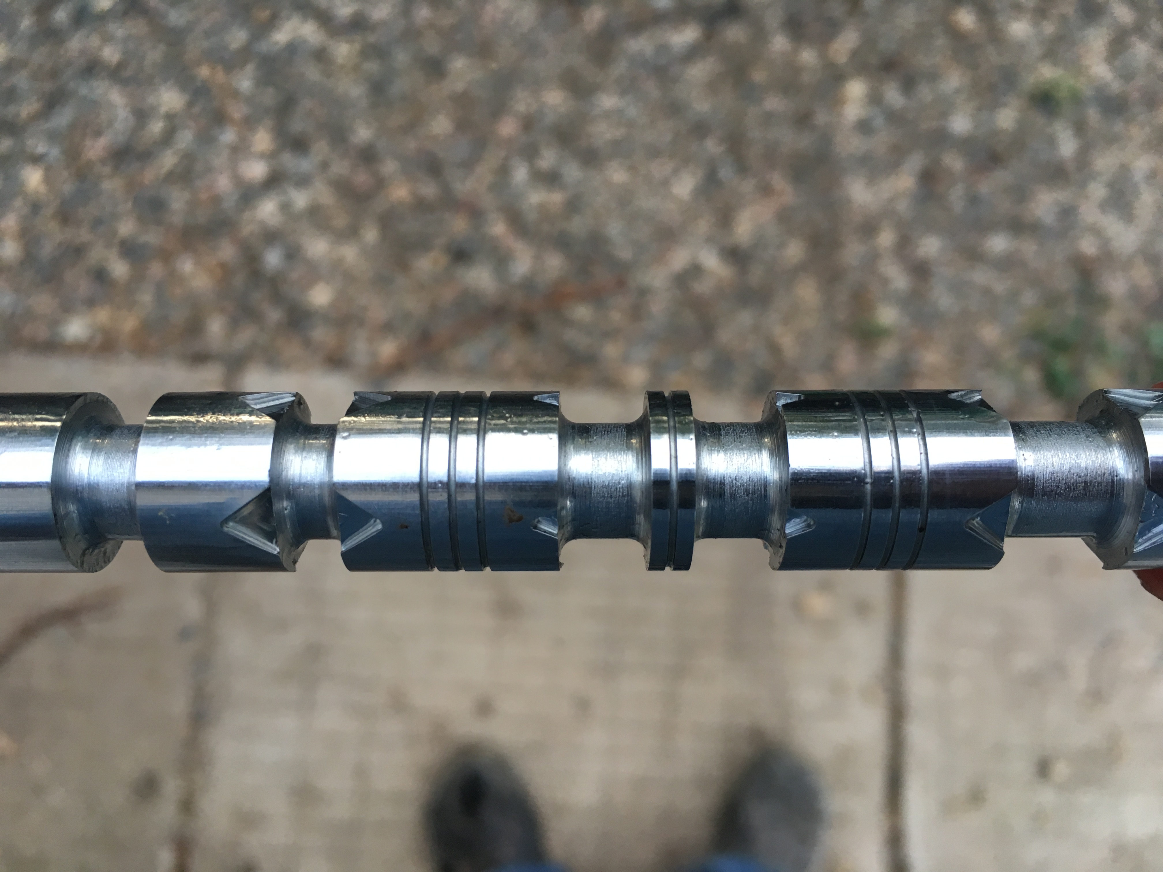

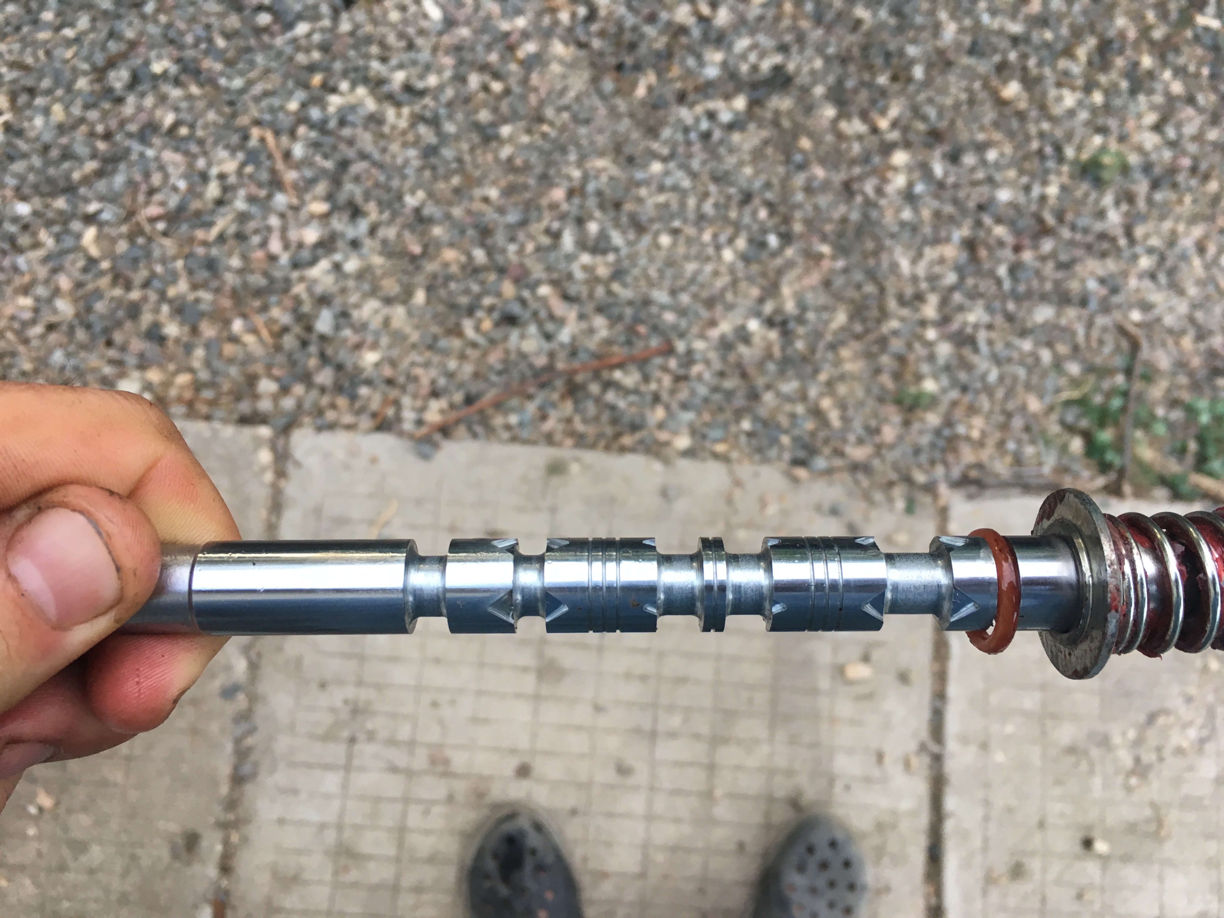

The valve is an older version of a Nimco CV112. It doesn't have a relief valve, it just has a plug, which I checked and the o ring was still on it. I checked the cables from the joystick, they seem fine. The spools move in and out ok. I took the spools out, they didn't show any obvious problems. The springs seemed good. The O rings on each end of the spool were there and intact. No external leakage.

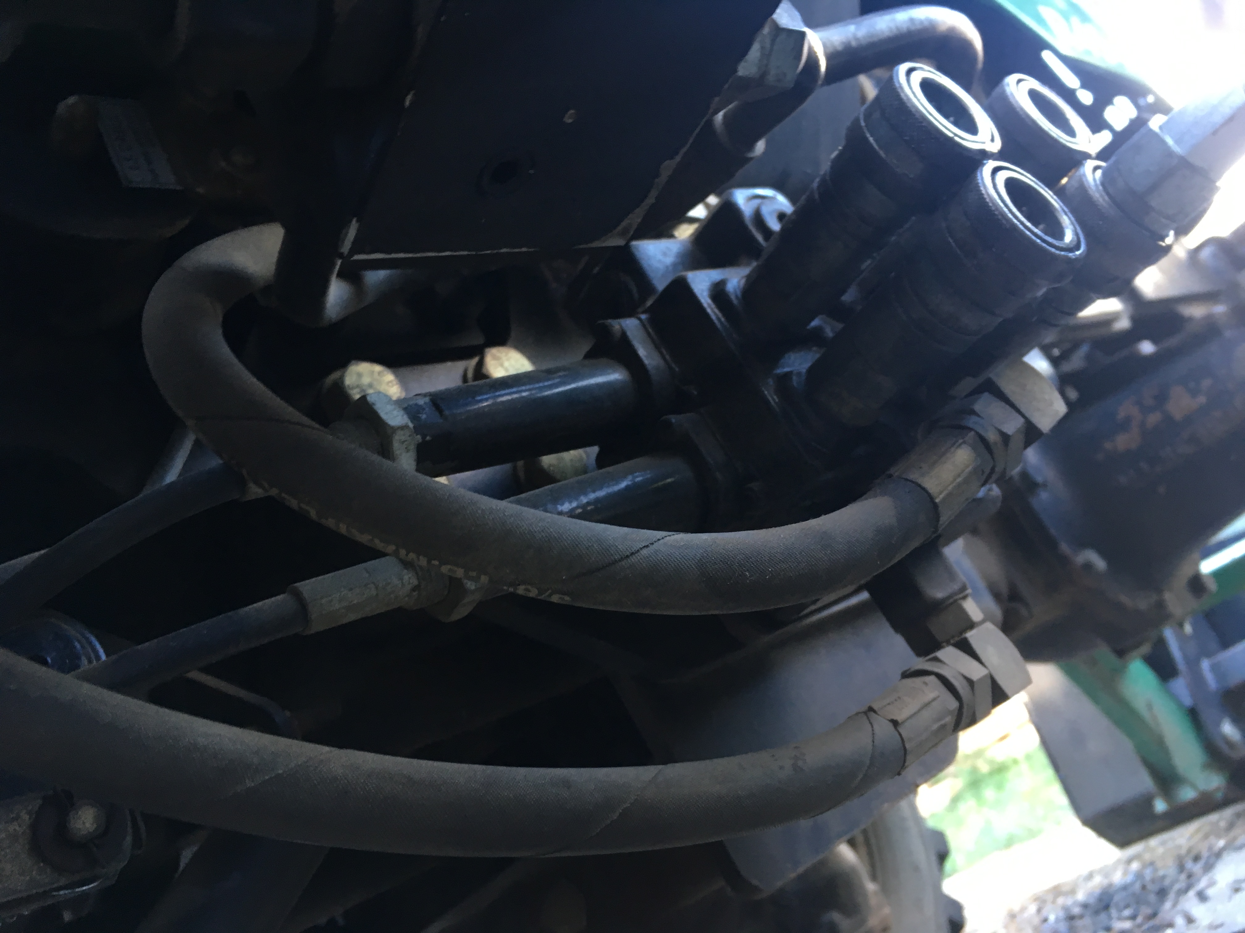

I attached the photos that I had on my phone for putting it back together, they mostly show how everything is connected.
My theory right now is that either the plug that is in place of the relief valve was leaking pressure or the spools themselves are leaking pressure. Neither of those seem likely or common though.

2500 at rear and relief operating is good. 600 up front is not. ~600 on both circuits says something wrong with relief or a shot valve/crack internally I expect, or someone has played. Can you hear the valve relieving when you curl the bucket and hold on curl? Could try a small adjustment of relief and look for a change, could remove tank return line and see if oil is flow to tank when it shouldn't be.

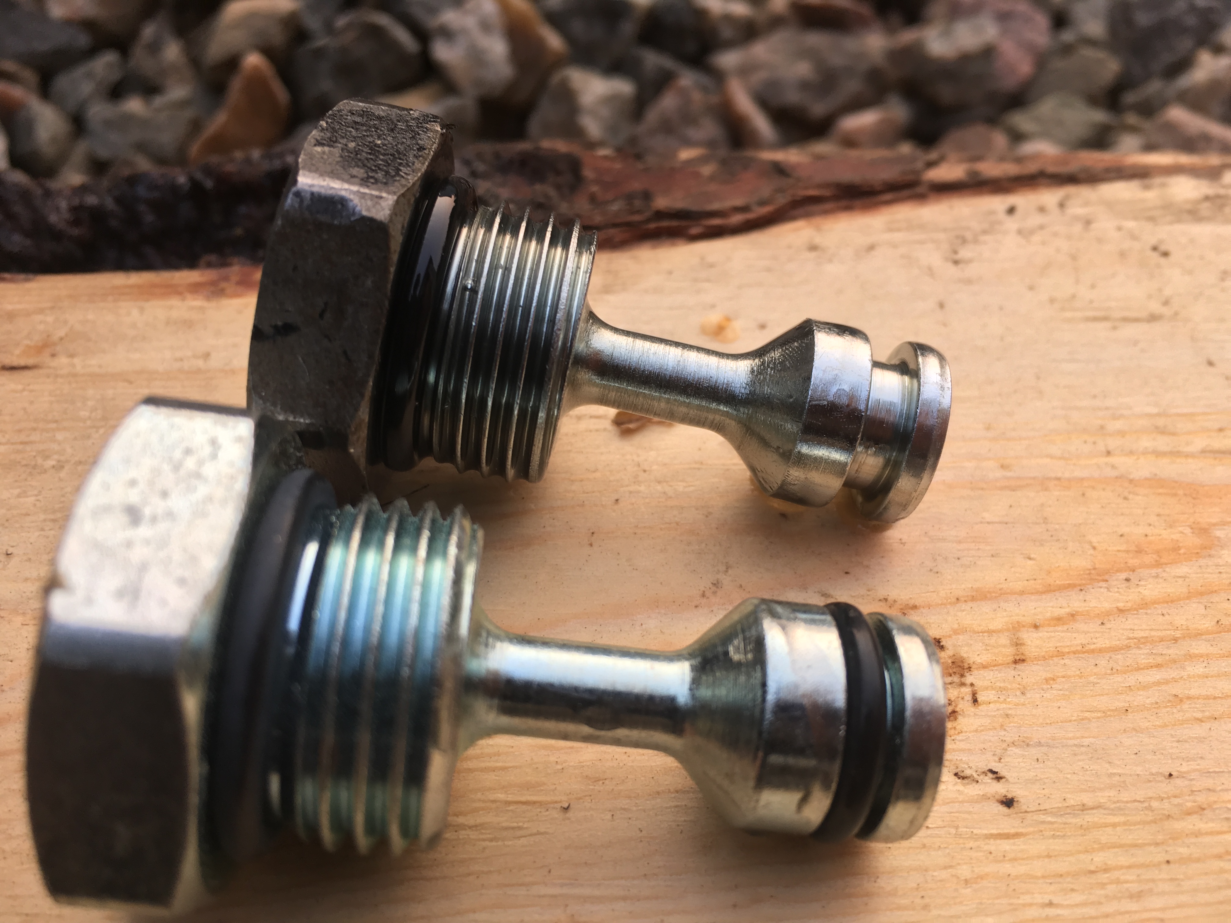

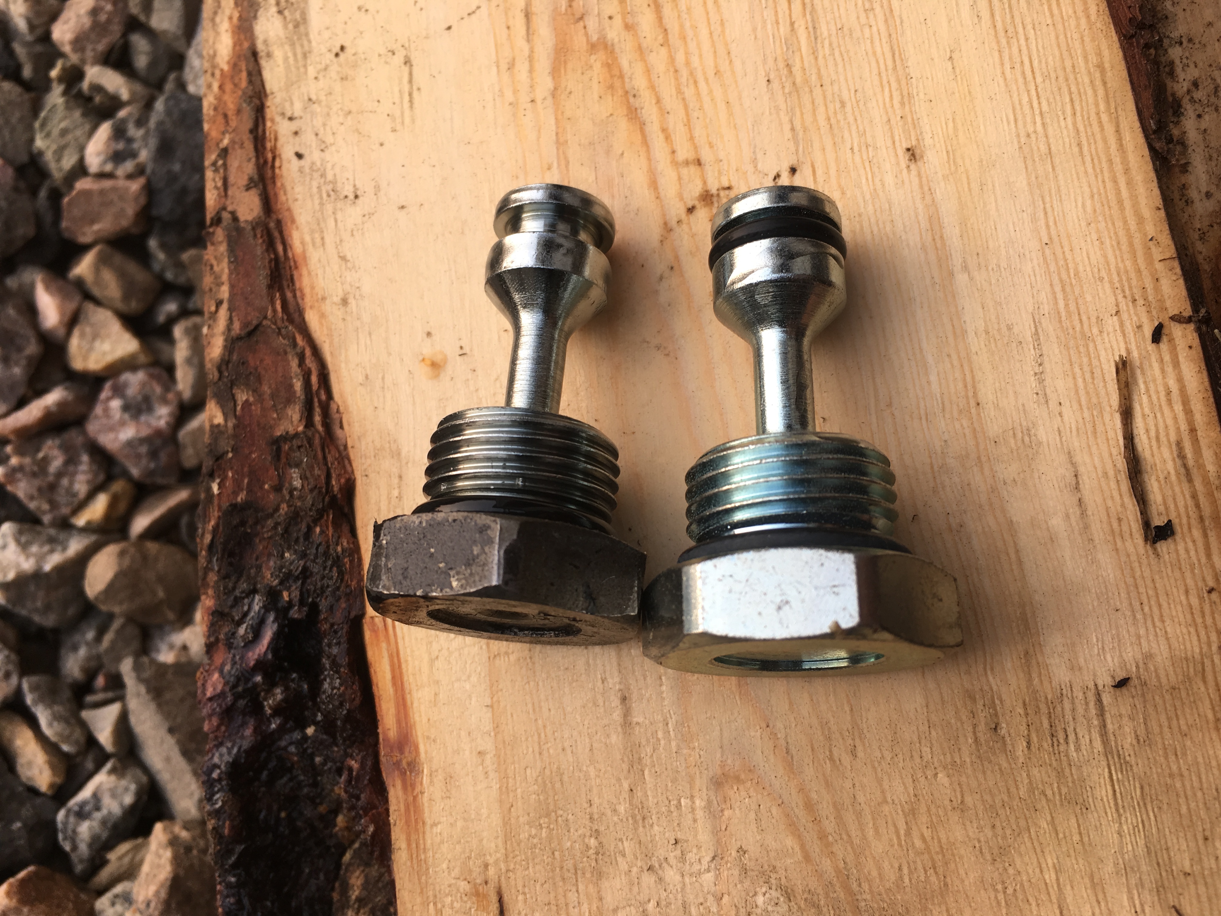

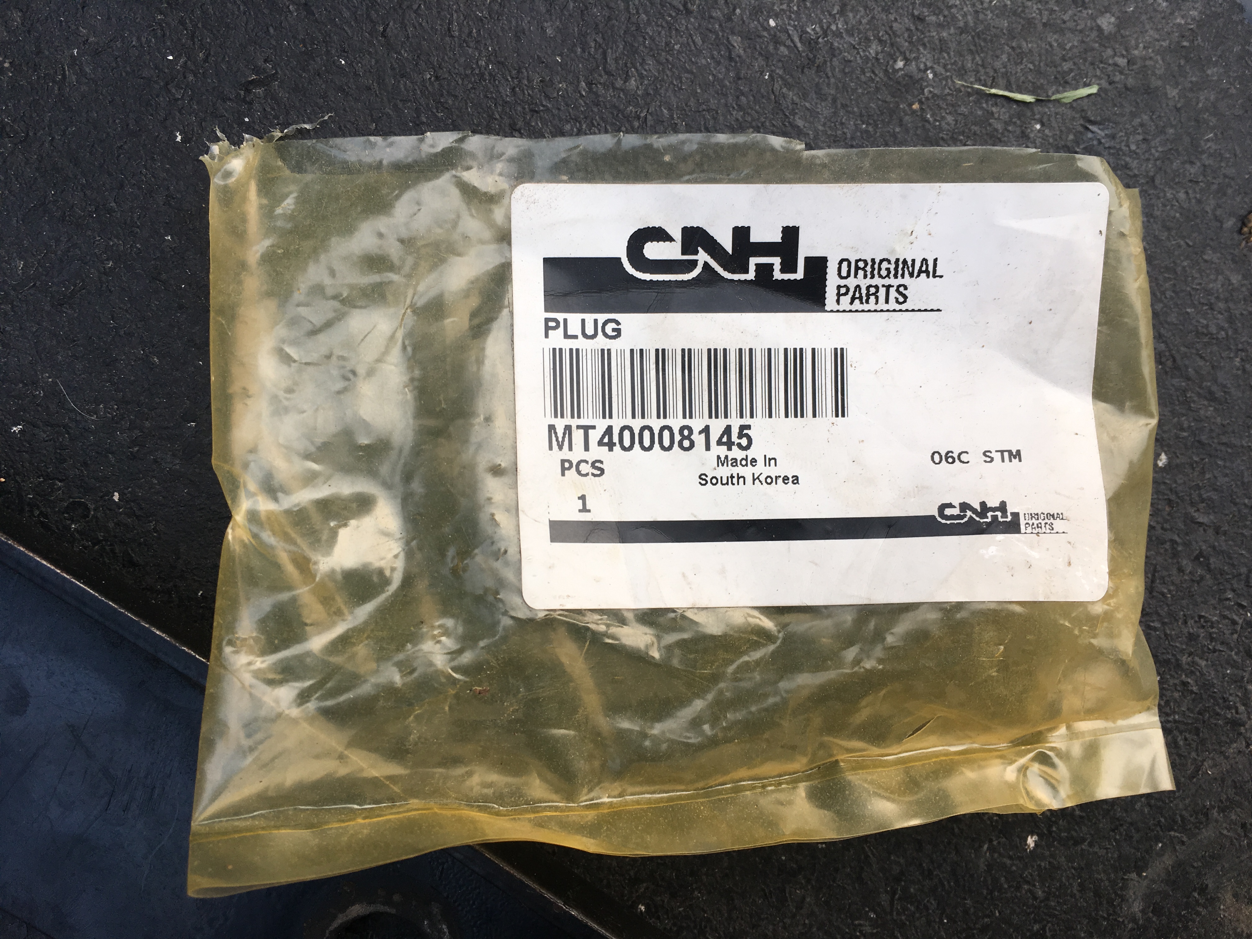

I think your on to something oldnslo. I pulled the plug above the pressure release in the hydraulic block and it was item number 3 on the front outlet valve diagram. So when there was no front loader, that plug was put into the front side which basically allowed oil to flow from the pump then turn the corner and head to the back of the machine. When they put the loader on that plug blocks the aforementioned path forcing it to go out and through the front loader valve. The plug looks like it's supposed to have a o ring on it. I'm working on ordering a new washer or plug.
It would make sense though, basically it's allowing medium/high pressure by it which is then going into the back side of the loader valve, decreasing the pressure differential. That's also why the rear remotes get full pressure, because it doesn't matter if that particular plug is bypassing or not.
Does that seem to make sense? I'll let you guys know how the new plug works.

I agree with that plug missing an O-ring. Yes from your description of its location it would cause the symptoms you are experiencing.
   / Slow and Weak Loader on Montana R4944HST #9
That plug should definitely have an O-ring and also a backup ring. My Branson has a similar block and I had to swap that plug to the other position where it allows to add a valve in series with the circuit. And I've noticed not only the O-ring but also a backup ring.

The problem has been solved. I installed a new plug from New Holland and we are up and running. It's somewhat frustrating that I spent a lot of time and money for a $20 problem that took 30 seconds to fix but such is life. I guess its the price I have to pay for experience. I've attached some pictures of the old and new plugs. It's exactly as ptsg described. The o ring was just missing.
Thanks everyone for your help, I really appreciate it. I've fixed a few other problems on this tractor too but I'll post those in the Montana form once I get some time.
