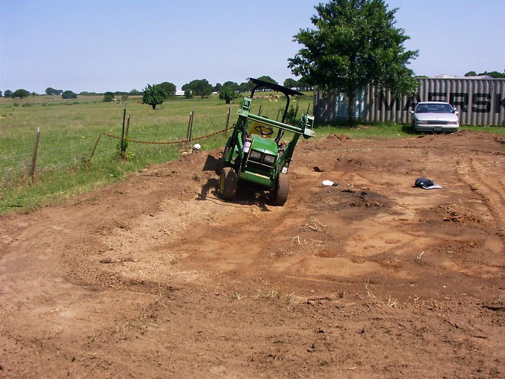

he calles me up to come and set his tractor back on it's feet..
when I got there the first thing out of his mouth was "Virg, I was going too fast".

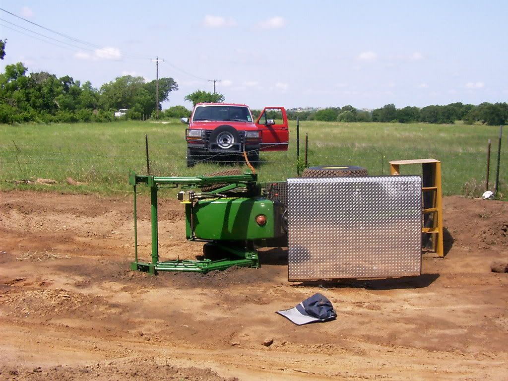

:eek: look how high those loader arms are
   / slow down #5
Dang.. the loader arms are way high on that? SCUT.. no wonder it rolle dover.
Hope it and the op are ok.

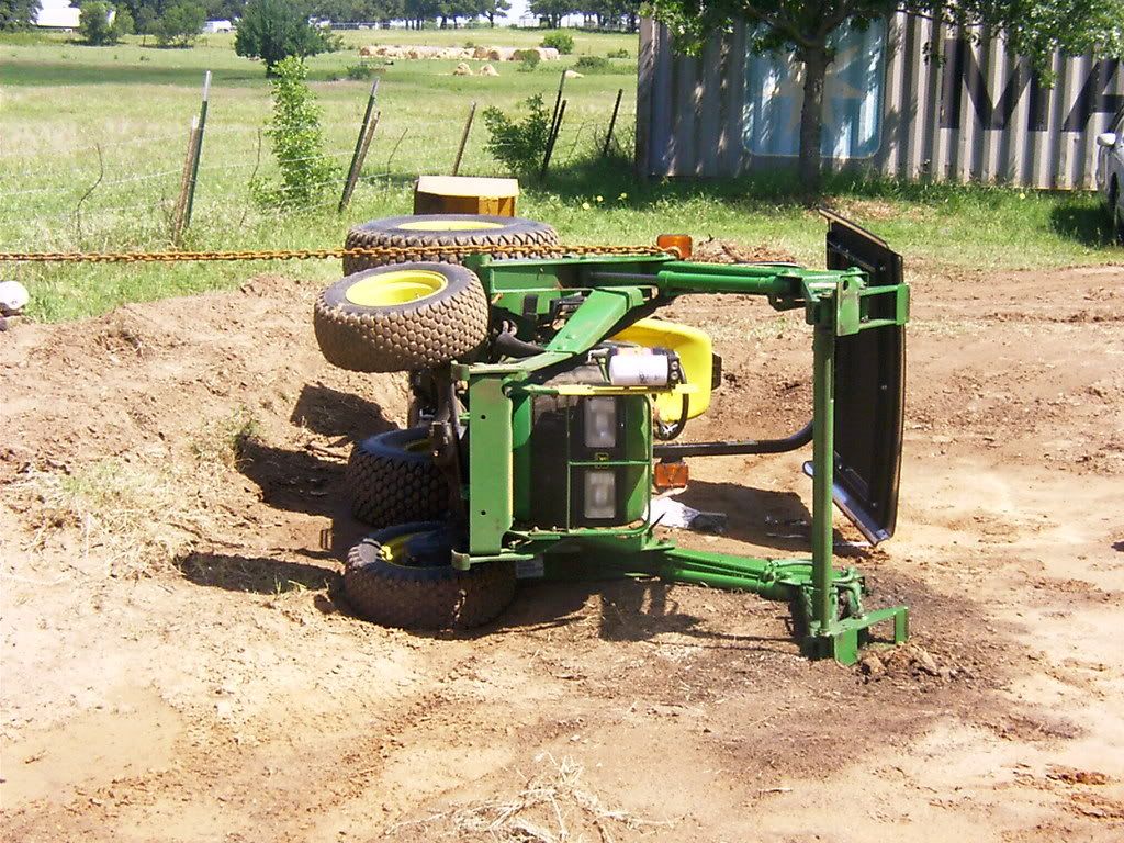

That first picture is rather startleing to me. If that chain slipped off somehow (which they have been known to do) it looks like it could go straight through the windsheild. I also like to use the tow hooks on the front of my truck to pull stuff since it make it easier to see what you are doing. However, I try to use the one on the passenger side (that seat empty of course :) ) to avoid the possible. Just a thought.
   / slow down #7
I'm surprised there isn't fuel and oil all over the ground.
It doesn't hurt to put a heavy blanket or something else on the chain to help keep it from flying back if it slipped to help absorb some of the energy. I wonder if a line threaded thru the chain every 10 or 15 links tide at the tractor and the truck and about a foot or so longer than the chain (so it's not under tension) would also keep if from flying in the event the chain slipped off.
   / slow down #8
Dang...good thing he had ROPS...least he didn't learn a lesson the hard way.
   / slow down #9
I've seen guys run them thru some old fire hose, and then band clamped at each end to keep the hose from riding up.
   / slow down #10
Whatever is used, I still think some sort of "shock absorber" is a good safety precaution.
