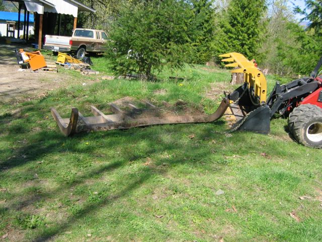

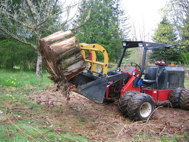

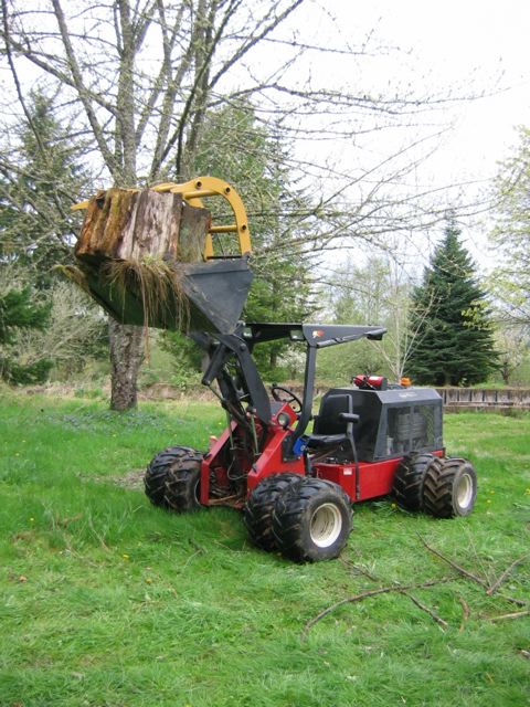

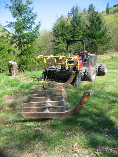

Today I promise I will get some slope and brush hogging pictures. It is just me at the farm this week so I am a bit stymied in picture taking. The first is just some cuttings I have in the grapple, and the second is something wonderful I found with the brush hog (Boy did that make one heck of a noise)
