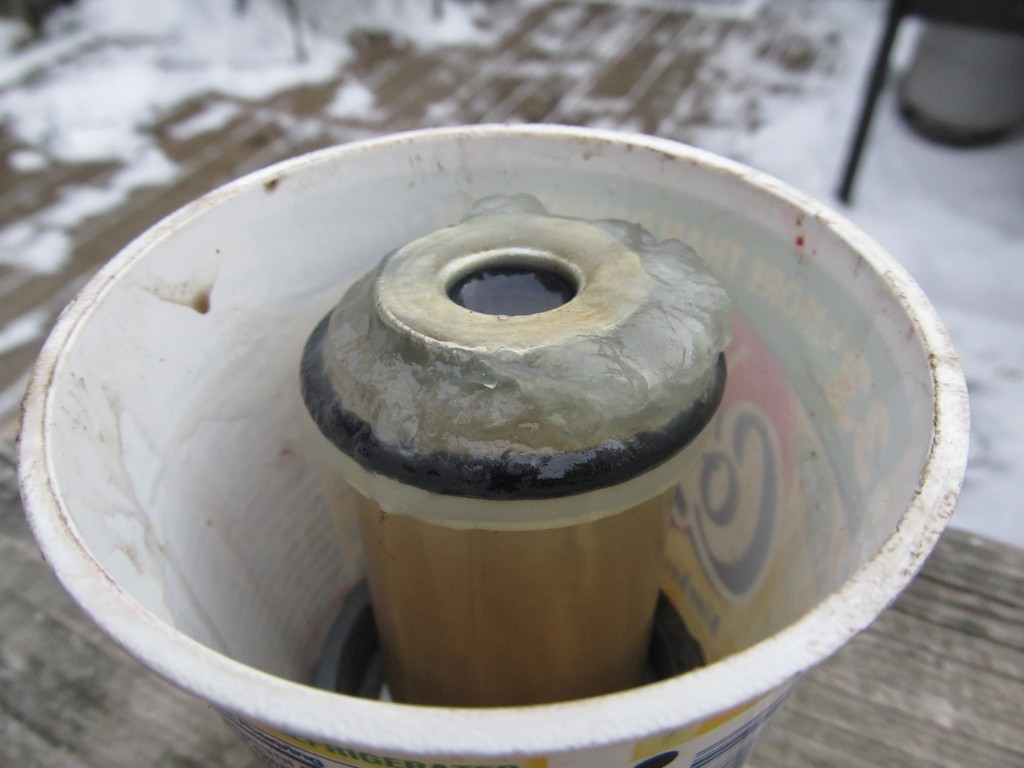

Greetings All,
I have 2816 geared with 205 hours. Has FEL, backhoe and just added grapple. When running the tractor will bog down like it is under a very heavy load. Will stall if I let it. I push
in the clutch and it will build back up. It was doing this when cold (just near 30 degrees) so I let it warm the next time and it still did the same thing. Now it does it even when
the engine is warm.
Any ideas what this could be?:confused3:

Two things come to mind.
1) Dirty fuel filter
2) Due to O.A.T. of 30 Degrees there is a possibility the fuel is starting to gel up.
Check your fuel filter for cloudiness or a waxy substance. If you can see that the fuel is starting to gel. Replace the filter and add a product such as Power Service or similar that will prevent fuel from gelling once the temp drops below freezing.
Note that even if the engine may be warm, the fuel is not heated and is still at the 30 degree temp.

Your symptoms are exactly the same as when the fuel filter on my 2216 gear gelled up. It was lower than 30 deg when this happened to me, but as others stated it very well could be filter related.
