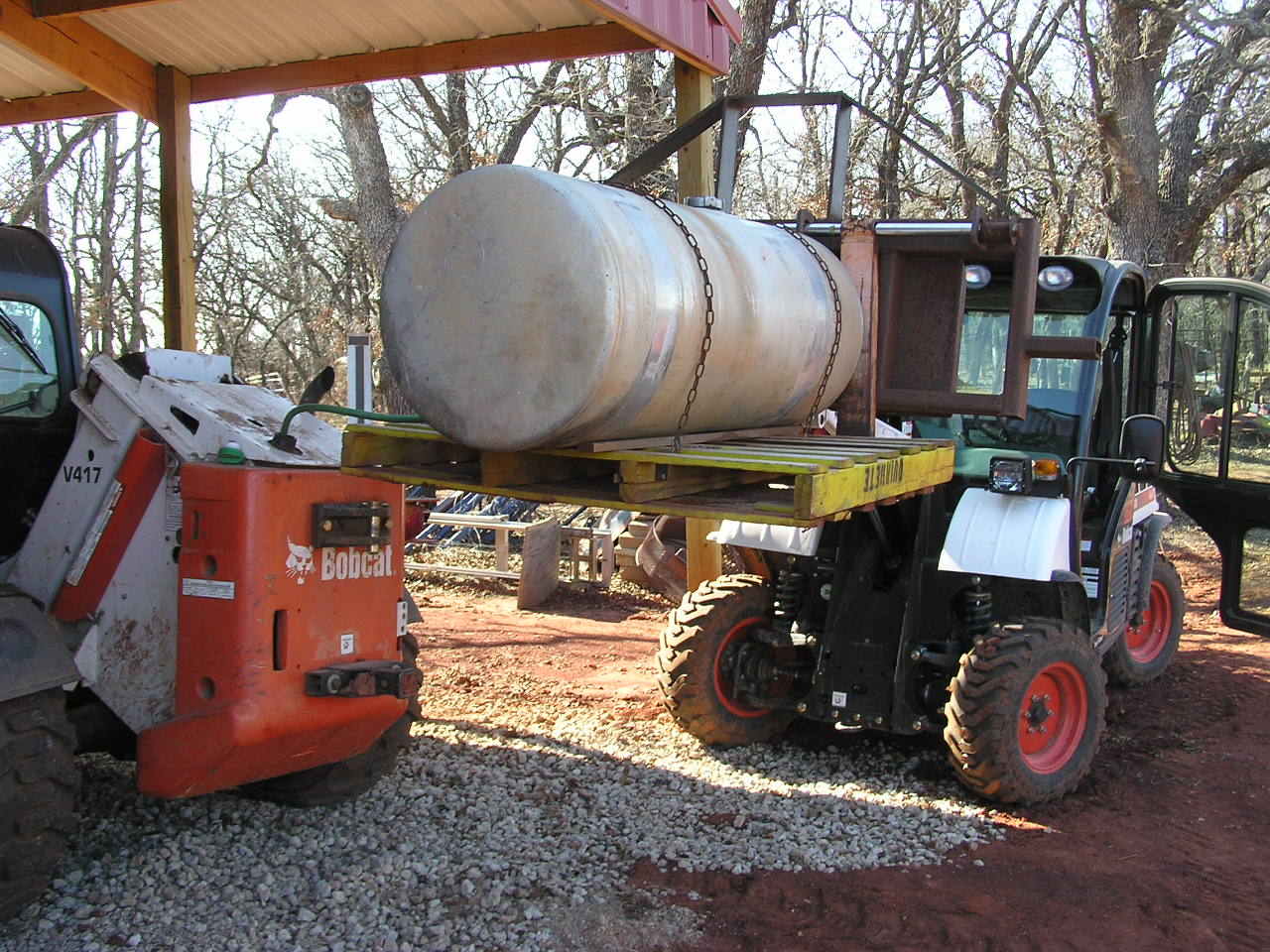

Chain it to the loader, then you don't need the pump. A valve that fits the 3/4 in nozzle should be under ten dollars.
   / Small Barrel Fuel Transfer Set-Up #8
Tipping that barrel over and getting it on something to support it will present some challenges, but not insurmountable. All this equipment has got to be good for something, right?
For future use, stand it up on a pallet and siphon the fuel.
You can pick it up with your FEL to fill the tractor.

I would fill it then lay it down and not disturb it to let the crud settle out, or build a stand high enough so you can refuel your tractor by gravity with a fuel hose & nozzle.
Moving the barrel will stir up the crud.
