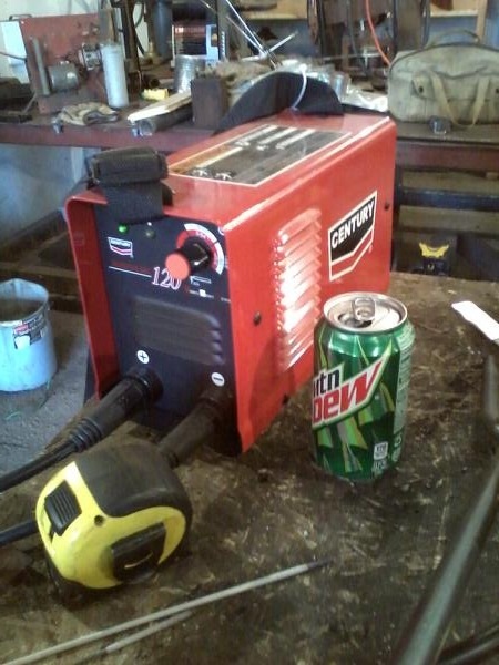

I bought one of these little century inverters on a whim once just to see what they would do.
$100 new in the box. Stick welding was ok, nothing great, but ok.
But when I clipped a tig torch to it for laughs, it welded really nice :) who would have thought...
   / small dc welder for scratch start tig #9
Very similar looking to the HF unit. Knob placement is different, but gotta wonder if they didn't come out of the same plant.
   / small dc welder for scratch start tig #10
I bought one of these little century inverters on a whim once just to see what they would do. $100 new in the box. Stick welding was ok, nothing great, but ok. But when I clipped a tig torch to it for laughs, it welded really nice :) who would have thought... <img src="http://www.tractorbynet.com/forums/files/welding/387603-small-dc-welder-scratch-start-image-jpg"/>
Good to know. As you say, 'who would have thought'.
