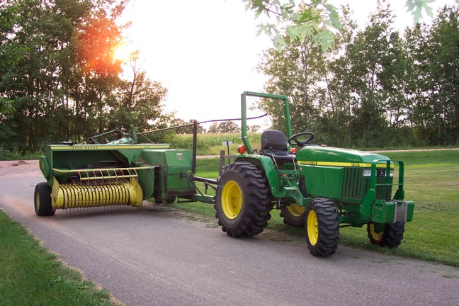

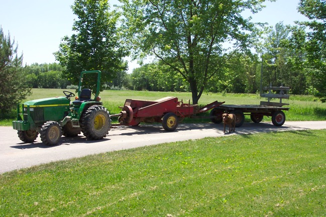

I have been using a 27HP Jd 790 for the last 3 years to make my own hay and a little to sell. I have a New Holland Compact 65 (from 1965). This makes a bale that is about 20% smaller than what is considered normal. With that being said I have also used a JD 336 baler on my tractor which is a larger full sized model. I have found that my tractor ran them both with equal ease. In fact, the JD 336 ran a little smother. I beleive this is due to the fact that on a JD baler the flywheel is mounted on the side and spins in rotation with the direction of the plunger. New Holland mounts theirs on the front in line with the PTO shaft. I beleve the JD flywheel helps take up some of the push of the plunger in the way they are mounted. This helps considerably on a smaller tractor becuse that plunger can really push you around.
It is when I was using a kicker that I felt that I did not have enought power. When conditions are just right (dry hay, flat ground, etc.) I can do it. It is taxing on the system and you feel it but it can be done. If conditions are not right you will not be able to do it as the rest of the system suffer due to the tractor slowing down each time and strugglin gto build up moment again.
Also, I use a sickle mower to cut. If you use on of these please be careful! Make sure all your pets and neighbors pets are secure whenever you are cutting hay!! Very Important!
I hope these experiences help.
