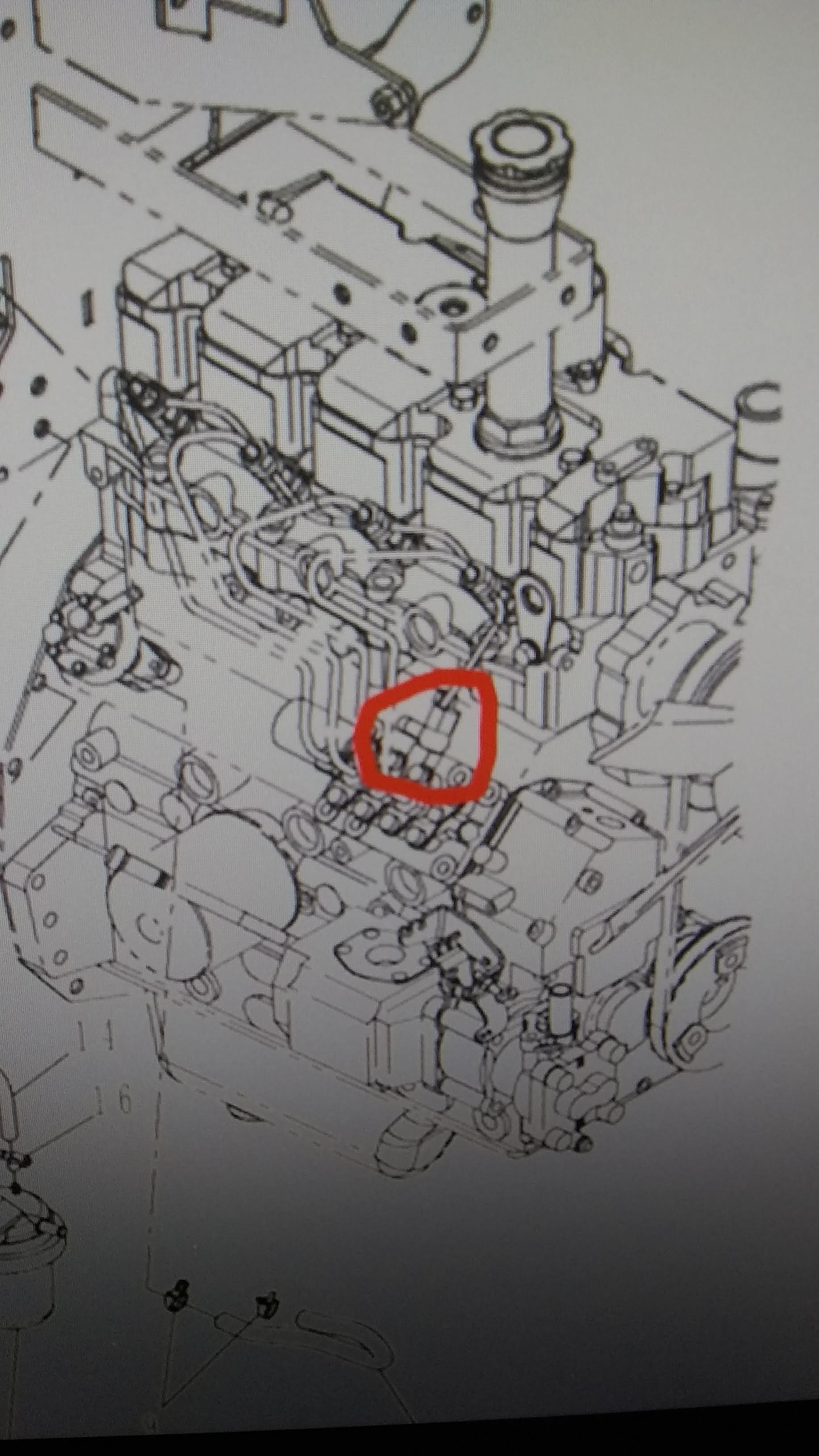

I have a 2006 Case DX45 and I noticed tonight that I seemed to be leaking some hydraulic fluid. I cleaned the area around the pump and attempted to find the leak. Luckily, I was able to find it rather quickly. However, I can't figure out what the hose part number is or what it does exactly. It reminds me of a vacuum line as it is only attached with a little spring clip. The hose is only about 6" long and I can't figure out what it attaches to on the top end as I'm not too familiar with what all of the parts are in the hydraulic system. The bottom end attaches to what appears to be a T of some sort. Coming off of one of the other sides is a larger rubber hose that attaches with a hose clamp and runs back towards the cab and ends behind the fuel/water separator. The hose has a hole in it just above the T connection and I think my problem will be solved if I can get it replaced. I appreciate all of the help!

Here is a picture of the part from a parts diagram. However it isn't part of the diagram and I can't seem to find it on any of the others. The part itself is actually fine, its the small hose coming off of the top of it that is the issue.

Are you 100% sure it is hydraulic oil and not diesel ??
from the pic it looks like part of the fuel return line system...
   / Small hose identification needed
I just figured out it is part of the diesel return line. It is part number SBA068209622. I have one on the way and hopefully will be good to go before long. I appreciate the help!
