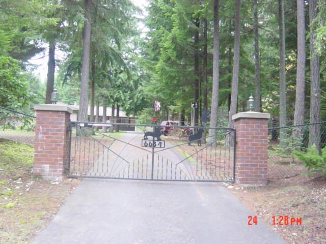

Here's one I built about 30-years ago.

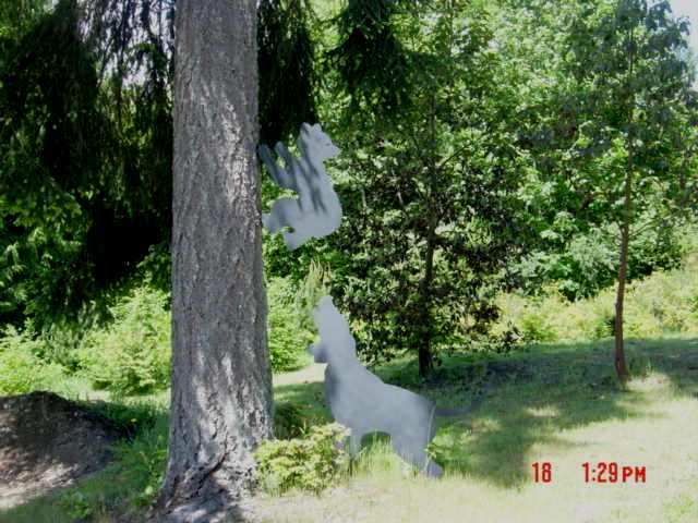

The hound and bear? They are behind.

Those brick columns were one of the last projects my dad did before he died. :(
