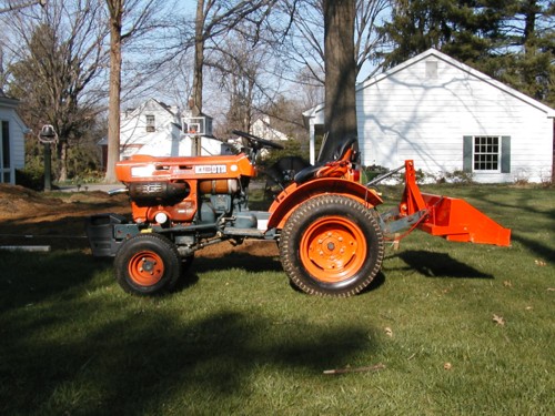

I'd like to add a rotary cutter to my Kubota B5100D4WD, see pic. My manual says max capacity is 44" 250#. Everything I find is larger and heavier. I won't need to use it a lot - so light duty is OK. Any thoughts? I would consider a 3pt finish mower but would like to keep the cost below $500. Thanks for the advice!

Can't help you on the mower, but what a beautiful old Kubota!
