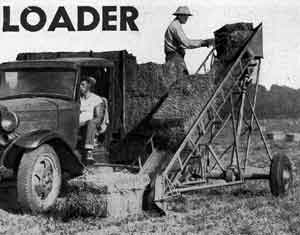

I'm just thinkin' here. Anyone seen any videos or pictures of a small square bale handler made from a pickup truck. I've seen bale beds made for big round bales but nothing for small squares. There got to be someone with a crazy imagination besides me out there that's already experiment with small time bale movers. I'm thinking moving 20-30 bales at a time to a close by stacking area. I know most people just go buy factory made stuff. I'm a real backwoods, gotta build it myself nut job. Lots of old pickups setting around me. No cheap labor either. If the hays gonna be move off the field I gotta do it. I've seen some real crazy stuff on the Internet so if you seen something like what I'm talkin' about post a link. bjr

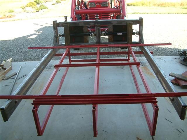

"There got to be someone with a crazy imagination besides me out there that's already experiment with small time bale movers"

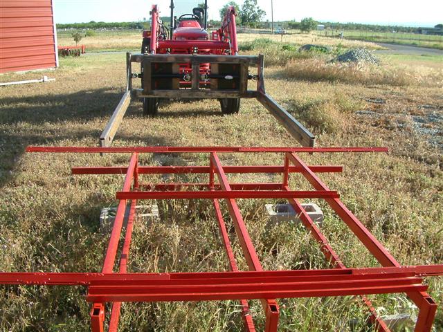

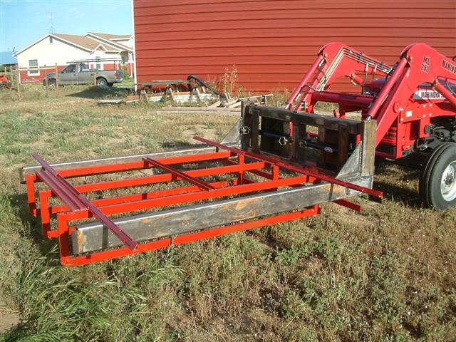

I may qualify as crazy. Here's the combination bale accumulator/bale squeeze I built about 6 years ago to work with my 2008 Mahindra 5525 tractor.
Sized for 8 small square bales. Got to the testing stage but my attention was diverted into other projects. Sold it when I sold my 10 acre ranch earlier this year.
Good luck

Old school busses with the body cut off were common at one time.
