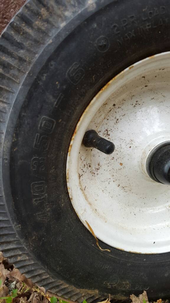

I have DR chipper with 410/350-6 tires. There are dry rot cracks and one keeps going flat. Replace or tube?

Thank you Steve. How hard are tires to mount on those rims? I had no issue inflating fully flat, off the rim tire, but have not tried mounting one.

I have DR chipper with 410/350-6 tires. There are dry rot cracks and one keeps going flat. Replace or tube? <img src="http://www.tractorbynet.com/forums/attachment.php?attachmentid=465548"/>
Replace. Bought my replacements from Amazon. Better than original. $16 each.
