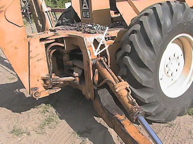

I had an old TLB stabilizer cylinder spring a leak. $750 cyl & all day R&R project.
Blacksmiths shop fixed it in 10 minutes only needed to pull a hose off to prevent heating motion.
Your friend is correct on all points. Let him work his magic.
Rattle can touchup paint if you need pretty & back to work!
