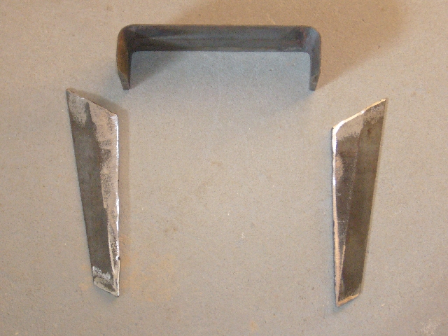

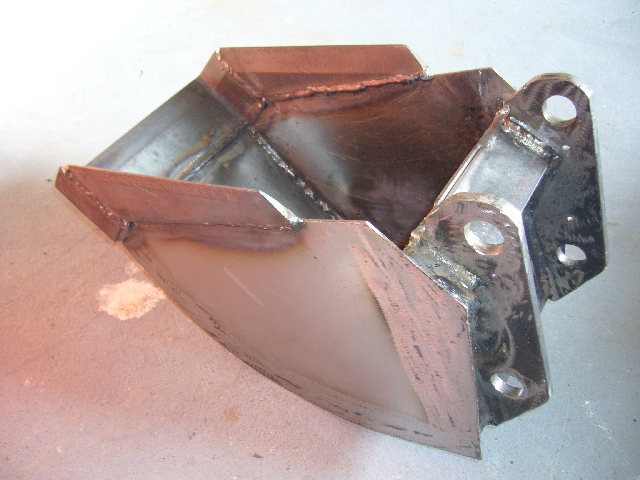

Cutting edge arrived the other day. Last night I cut piece for the front lip and bent it to fit, my bends were actually pretty close. This morning I cut out the side cutting edge pieces and cleaned up them.
Spent some time welding the edges on the bucket.

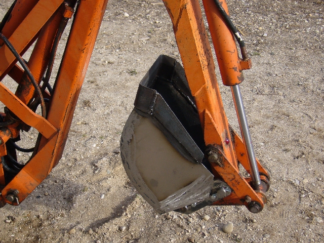

On the Hoe and Ready to Go!

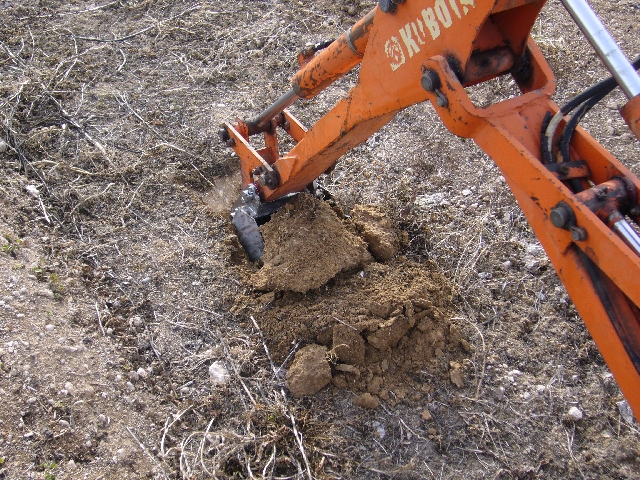

First bite! Took a little scratching to get it to go through the 2-3 inches of frozen soil but bit right in after that.

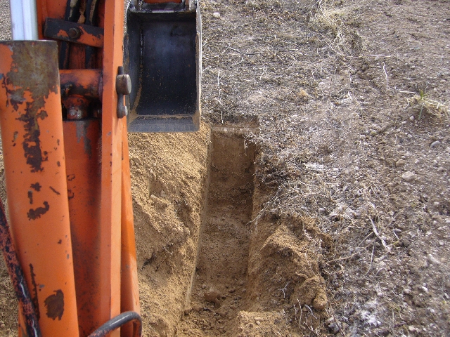

Test trench, little over 12" deep. Note that no soil stuck in the bucket. You can probably tell we have sort of a sandy loam subsoil. This spot is between some raised beds in my garden so all the topsoil has been rolled onto the beds.
Looks like I won't be needing the bucket teeth, as suggested it cuts just fine without them.
I guess I can call this one a success and move on to other projects... like taking the hoe off for the winter ;)
All told I have less than $80 in this project and some of that is cutting/shipping fees.

Looks like a coat of paint and it will be indistinguishable from a factory piece!
I don't think you will have much issue with soil sticking. When I've had stuck buckets, it's been in areas with BLACK soil or when hitting a layer of wet clay.
I did double check your side cutters. My gut tells me that you cut them too short. More overlap with the bucket side would have made them stronger. Probably not an issue, but keep an eye on the weld. If you see it start to crack, weld on a piece on the bottom of the side cutters to re-enforce them. No big deal.

I noticed that both your new and old buckets have no boss at the "ears" for the pins. This is why your old pins wwere worn, ridged. The boss is just a short length of bushing stock welded to the holes of the ears that increases the bearing width of the pin against the hole. If you find your new pin wearing think about adding these "hole extensions". You may want to do this on your large bucket as judging from the original pin you took out, the holes are probably worn and likely a bit out-of-round. Sorry I didn't see this sooner so I could have mentioned it earlier.

Looking at charlz earlier photos it looks like the side cutting edges are pretty much a match from his old bucket. And when looking at the new bucket fully curled it seems the side edges need to be short to clear the lever mechanism.

That sample trench is one fine cut, looks like it was done by a machinist.
