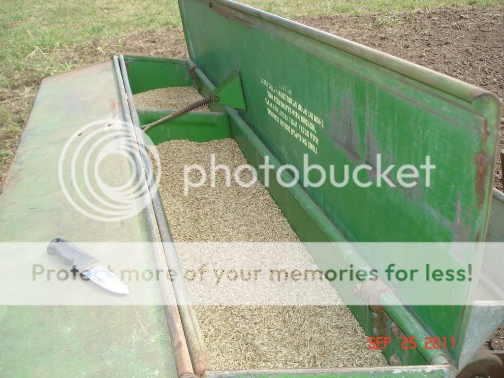

I couldn't get your links to open. What I did, was to find an old John Deere/Van Brunt model FB. It orginally was a 17 x 7 configuration. This drill drove 9 flute feeds off the right side, and 8 off the left side. The drive gears on the right side were broken, I got the drill for scrap price. I'd seen other drills cut down, and was able to figure out how to do it. I was even able to sell a few parts from the right side to help on the costs. The lift is a trip mechanism and doesn't need hydraulics. Now it drills 8 rows on 7" spacing. The big box will hold over 200lbs of rye/wheat. Last year I was able to drill winter peas out of the big box, and Daikon radishes out of the small seed box in the front. Finished width is just over 6'. It works great for small plots.
